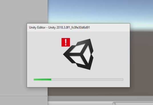

I appreciate the help and I attempted what you suggested. However, I still get an error followed by a crash. I attached a screenshot of what I see and then the next thing is Unity crashing. Using Unity 2018.3.8. I might try to download an earlier version to see if it works.
