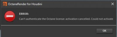

I'm not sure if this is the correct place to ask, but for some reason in houdini 17.5 with the latest build 2018.1.0.7 octane says my account isn't activated anymore? when try to reset it using license manager, I can relogin, but houdini crashes to desktop after a min of just sitting there after I try to login, restart houdini and repeat... now my houdini subscription is active and obviously worked fine with houdini 17, just wondering if 17.5 has prompted anyone else to re-activate your octane account?

snakeboxmedia wrote:I'm not sure if this is the correct place to ask, but for some reason in houdini 17.5 with the latest build 2018.1.0.7 octane says my account isn't activated anymore? when try to reset it using license manager, I can relogin, but houdini crashes to desktop after a min of just sitting there after I try to login, restart houdini and repeat... now my houdini subscription is active and obviously worked fine with houdini 17, just wondering if 17.5 has prompted anyone else to re-activate your octane account?
Here I don't have any problem with H17.5 and the licensing. The license should be activated automatically when you launch an Octane rendering (from the IPR, for example). If you have problems, I wonder if you have installed the right plugin version for your license (Entreprise or Studio) ...
Thanks,
-Juanjo

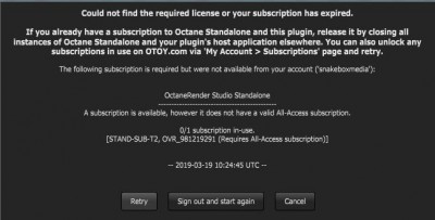

I'm installing this Octane_2018.1.0.7_Houdini_Win64_vr which is the studio subscription, it is the same version I have installed for 4.01.1.1, 4.02.0.0 and 2018.1.0.6 for instance, I just started H17 and there the license still works for 2018.1.0.6
it just says it can't find my license, but something is certainly not correct. I think it thinks im trying to activate the all access standalone, which im not obviously.. my env path etc is copied from H17 and just renamed to match the new version so I don't fully understand how it would load something wrong, but maybe?
I mean I must be doing something wrong I will try and install it again fresh.
EDIT1: yes I can see when I cross reference the License name it is referring to in the error box, it's to the all access subscription, which I don't have, as I have a studio houdini subscription, but none of the previous builds has done this?
EDIT2: I just tried loading the 2018.1.0.7 version into my H17 which worked perfectly fine with .6 before, and I get the same error, so there is something in the latest build that isn't accepting my license type I'm guessing?

Do you know if the final Standalone 2018.1 Studio subscription works fine on your system? I wonder if there is a problem with the plugin Octane core libs or something like that ...

juanjgon wrote:Do you know if the final Standalone 2018.1 Studio subscription works fine on your system? I wonder if there is a problem with the plugin Octane core libs or something like that ...
viewtopic.php?t=70809
Thanks,
-Juanjo
Ive never used the stand alone so not sure, but I will try!
edit1: Nope! getting the exact same error the first time I try to start octane standlone 2018. Same license prompt saying I dont have all-access subscription.
but like I said, it has only happened since the very latest build, so yeah maybe something is a little off?
