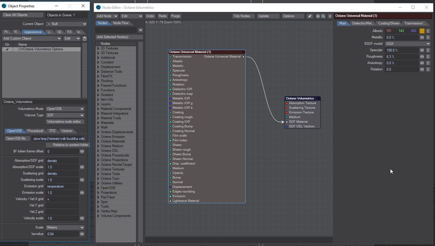

Hey Juanjo-
Can you please explain how to render vdb files as a level set geometry with an octane material? Does this only work in LW2019? Any vdb file we try to render with SDF checked does not render anything at all, no matter what surface we try plugging into the node, with or without a medium node plugged in as well. Is there a special way we need to create our vdb files to have specific SDF information? Please explain this function if you don't mind.
thanks for keeping the updates coming!!
juanjgon
Posts: 8867
Location: Spain
rustyippolito wrote:Hey Juanjo-
You only need an SDF OpenVDB file and a material linked to the "SDF material" input in the volumetrics node editor, as you can see in the attached image. This is the link to download an SDF OpenVDB test object:
https://nexus.aswf.io/content/repositor ... -1.0.0.zip
Thanks,
-Juanjo
2019-03-13 02_18_57-Layout™ NewTek LightWave 3D® 2019.0 (Win64) - sdfVolumes3.lws.jpg
