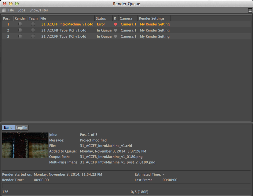

Since I am using the Que fuction I do not get an on screen error message but I will attach the render log
This is what the error looks like in the Que though
