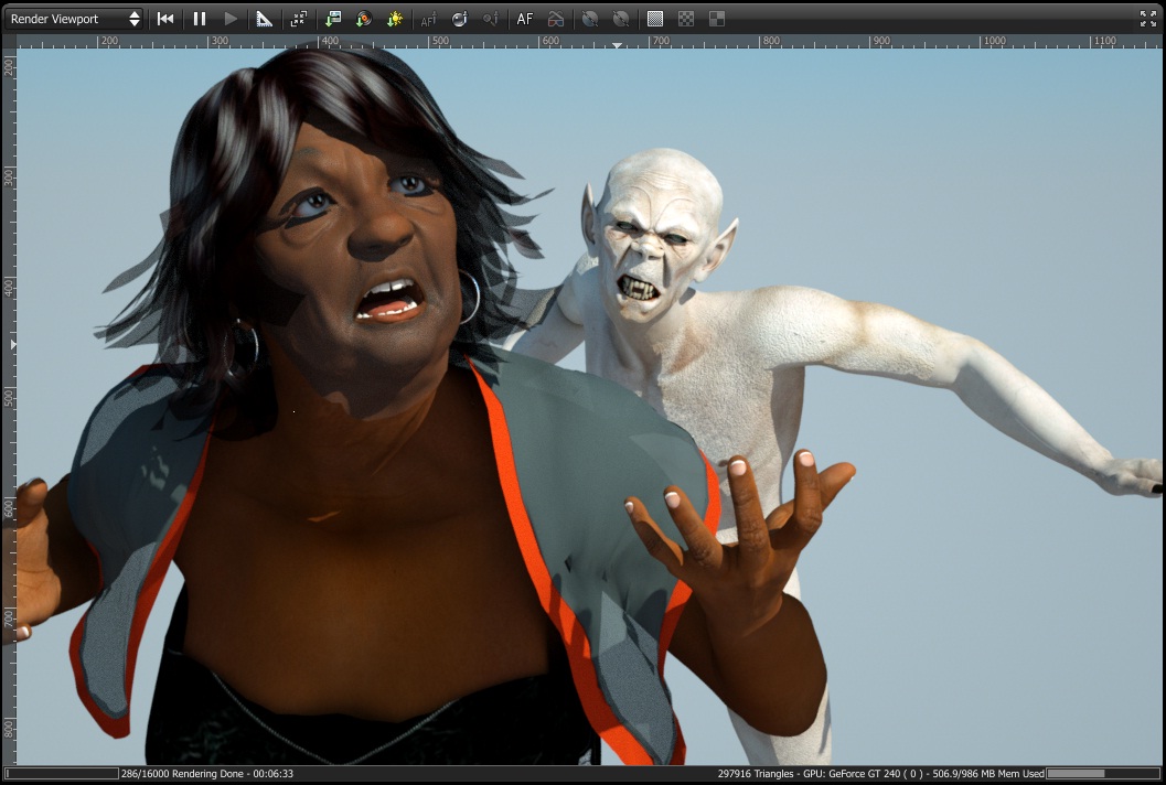

MaTtY631990 wrote:In live DB, you'll see I have added a skin material. Just take a look at the properties. ;)
Thanks for the skin setting here is what i got with a modified version of your skin material with 5min render New material on face only
Testing skin material

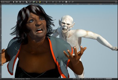

Tugpsx
Posts: 1179
Location: Chicago, IL

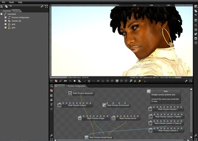

Been playing with Octane again on my new system along with multiple camera switcher rig.
Texture from DAZ3D, very nice with subsurface layer.
New skin texture over at DAZ3D
Multiple camrea switcher
More test
More test
