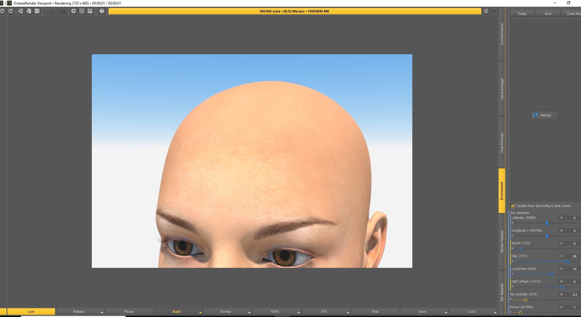

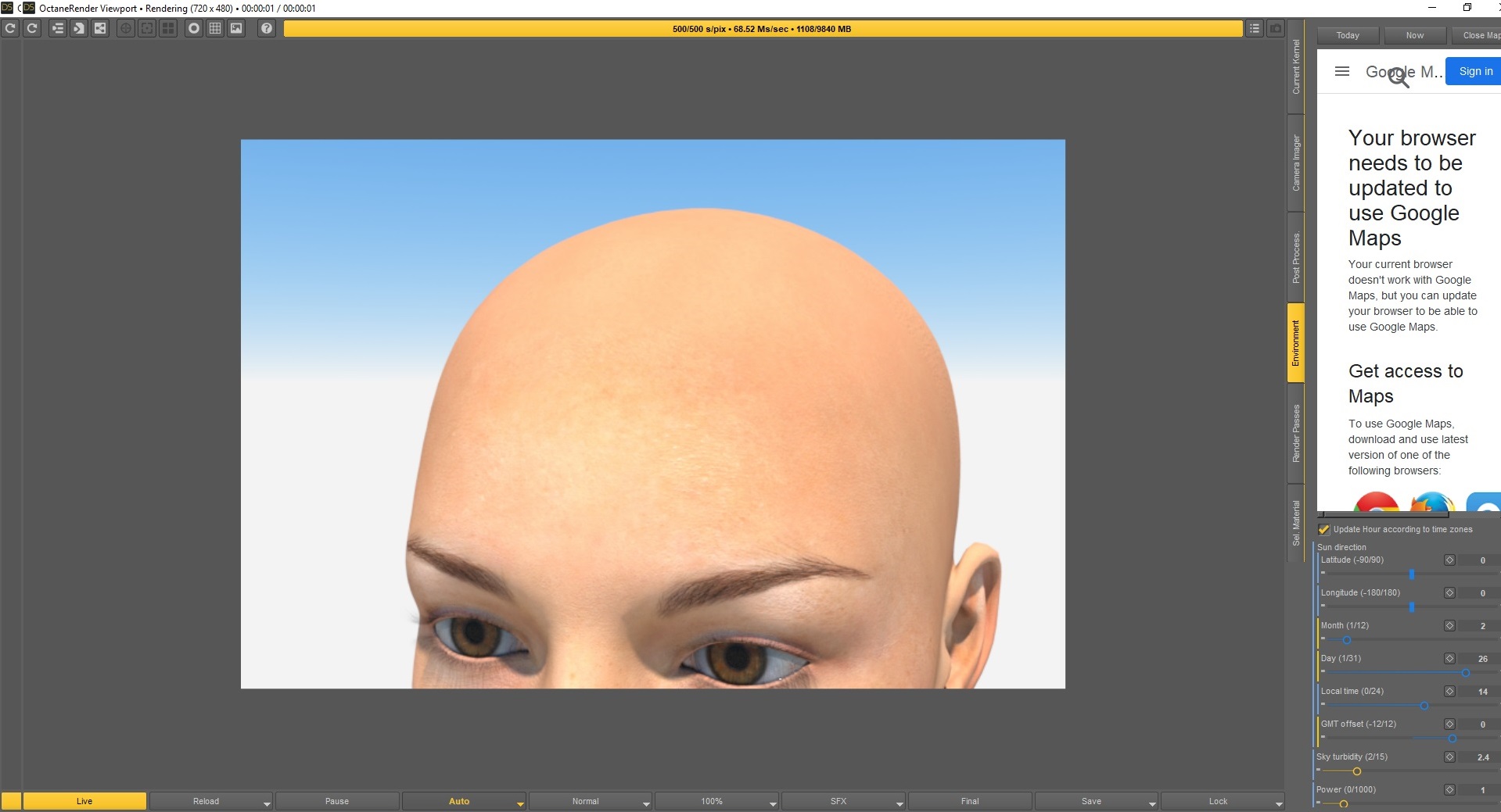

Hello, can anyone confirm if they have ever seen this behaviour from the plugin:
1) I Open Viewport and Click 'Open Map', but where I expect to see map it only shows a grey screen
2) Clicking on map area does nothing, but if I right-click, it shows 'Reload'
3) When I click Reload, it gives me this, but then there is no ability to login to my Google account because the interface is scrunched down and I can't use the sign-in tabs or buttons.
As far as the browsers I have, they are updated... I had this issue on the last stable build, and so I updated but it still is same.
Standalone seems to have a built-in map, I recall the earlier versions had this also...is there a way to set up the browser for the map
THX!
