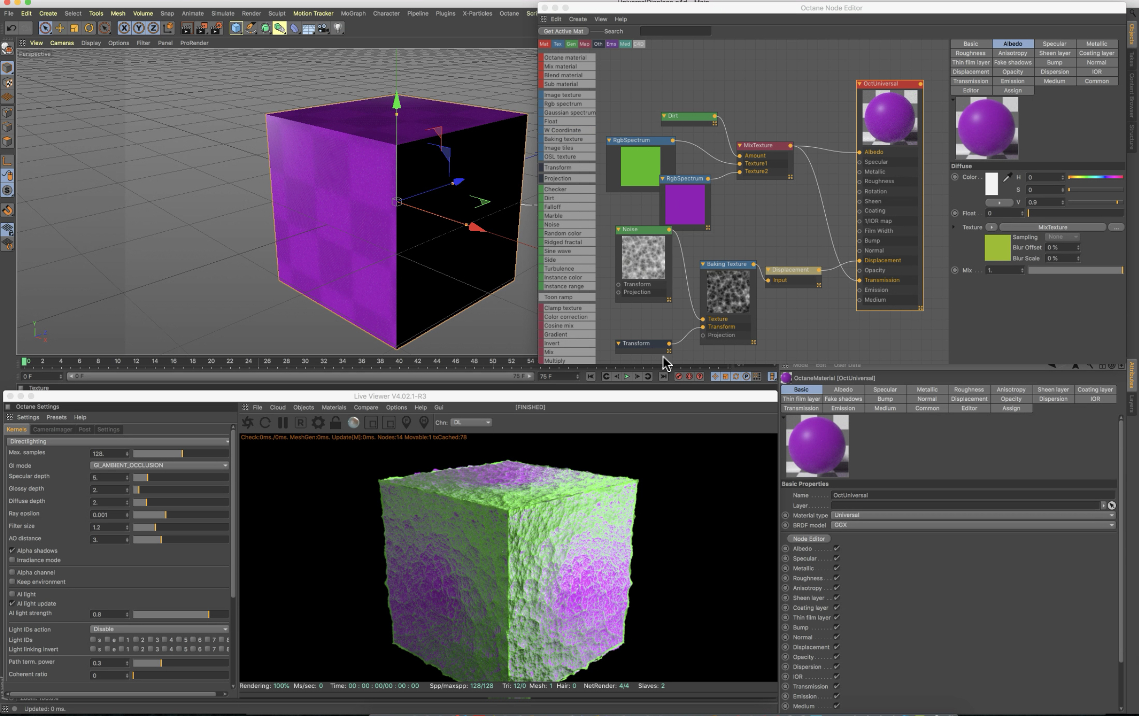

you need to use Octane displacement, or the c4d displace deformer, to make the dirt work as expected, here is an example with Octane Displacement and an Universal material:
universaldisplace.c4d.zip
(80.08 KiB) Downloaded 210 times
ciao Beppe

Question: why are you using the universal material?
Posts: 10522
Just for the simplicity to have all the possibility in one unique material node, without mixing materials.
