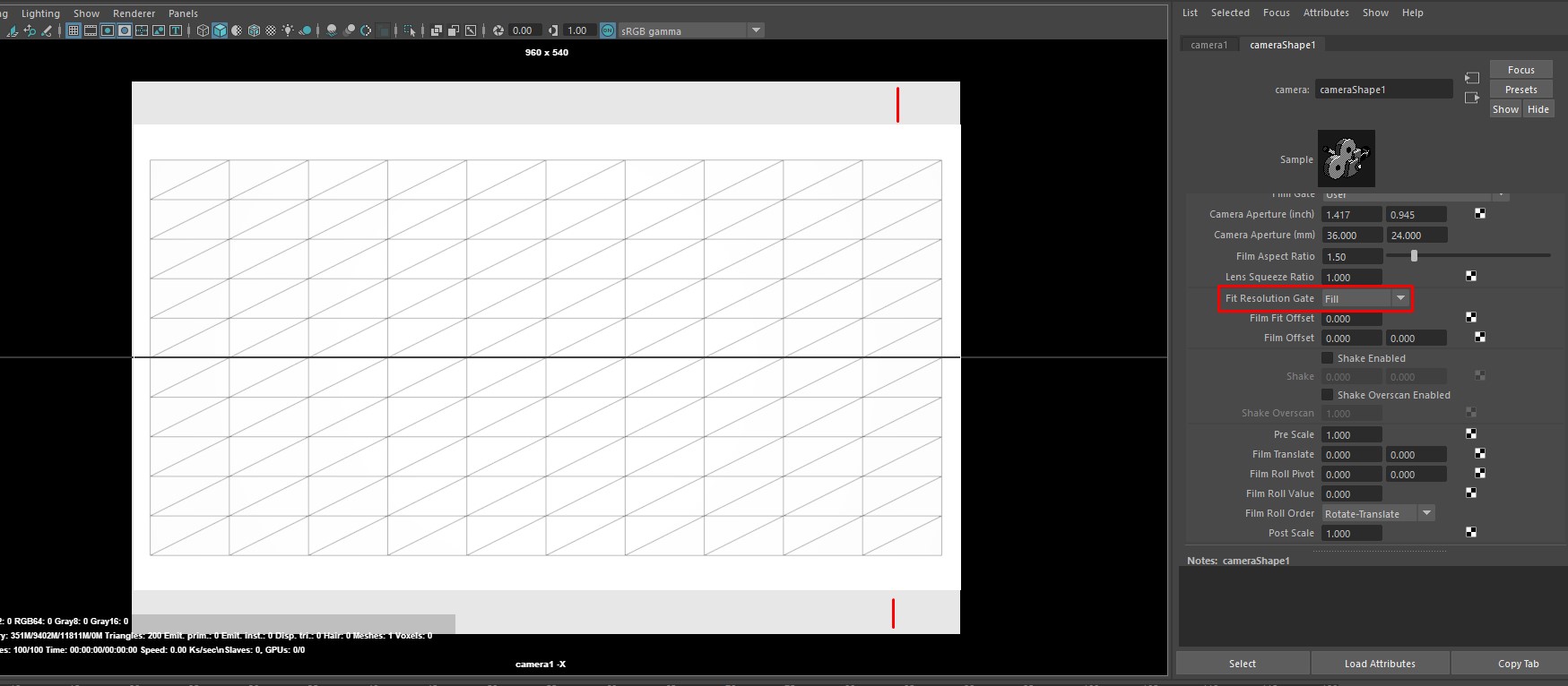

Hi Jim,
Here one other issue, on the camera option "Fit resolution gate" has being ignored and then the "VIEWPORT" and "EXPORTED SCENES" has wrong camera view and ratio.
the plug 3.06.4 is working perfect the refractory plug doesn't work right give us weird results here some screens.
Extra comment: Maya has the default cameras such persp,side,front and etc at Horizontal but when we create a new camera the default is "fill" I think need support both correctly
Cheers,
JO
accurate result
extra wrong ratio
Last edited by Jolbertoquini on Tue Feb 19, 2019 12:57 pm, edited 1 time in total.
