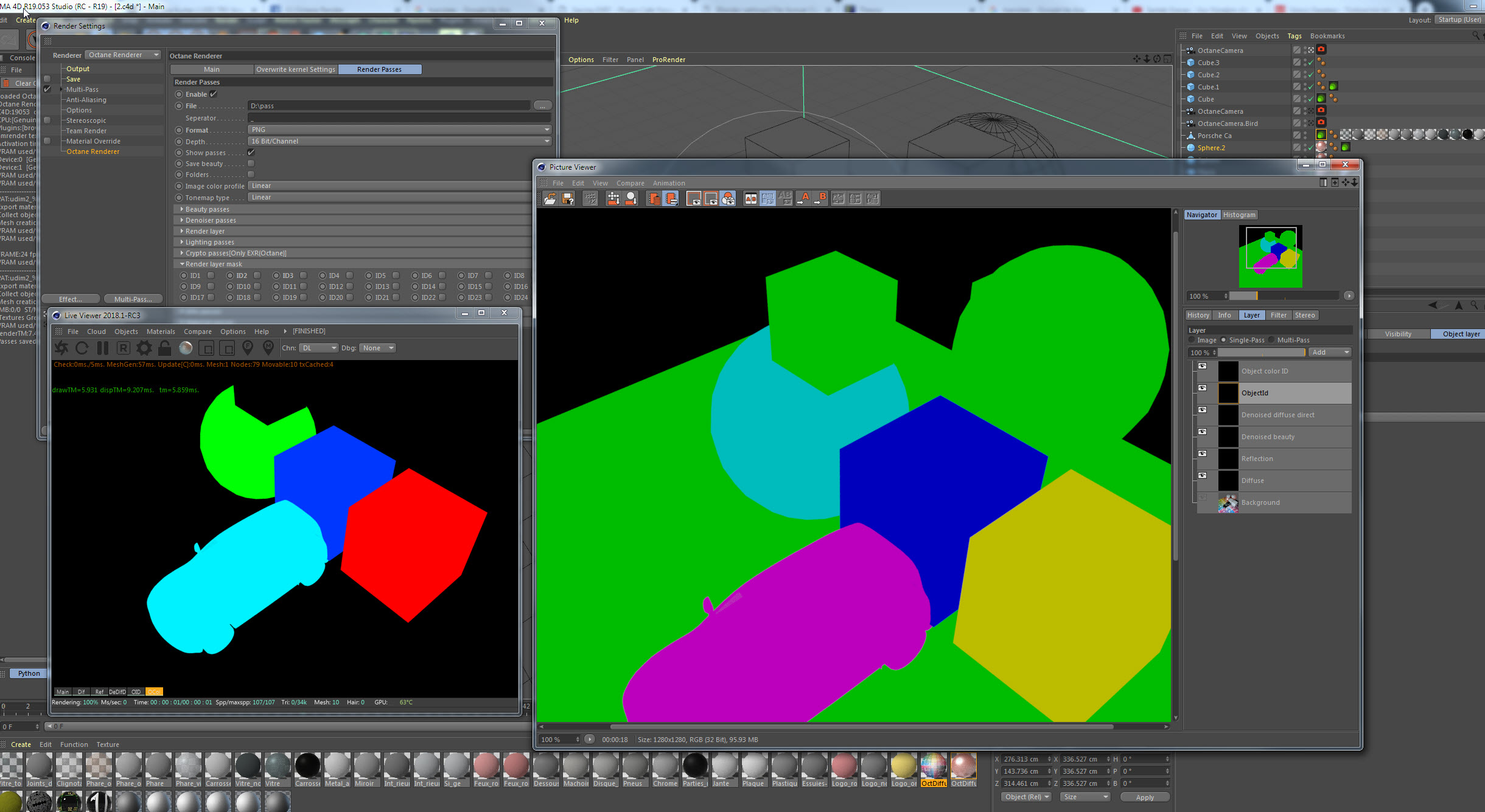

When exporting (in picture viewer) the info pass 'Object layer color' to an EXR 16 Bit (None compressed) file.
The object color layer results in a completely black layer.
Object layer colors show correctly in live viewer though.

Just tried 4.01.1, same result.
I attached a screenshot for hopefully some more information.
I did try a small test scene with just 3 cubes and that did export correctly.
So not sure it's a bug, most likely somethings wrong with my scene buildup?
Anyway I'll stick to 4.01.1 for now, as 4.02 gave me some crashes with resizing the live viewer as well.

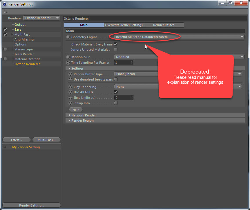

joacwast wrote:Cleaned it up a bit to keep file size down, problem remains.
https://we.tl/t-HrWqCY1Lk6
Thanks!
Remains because you're using a method which is not supporting object layers/volumes/etc... It's deprecated. I'd be happy if you remove your report from bug section.
