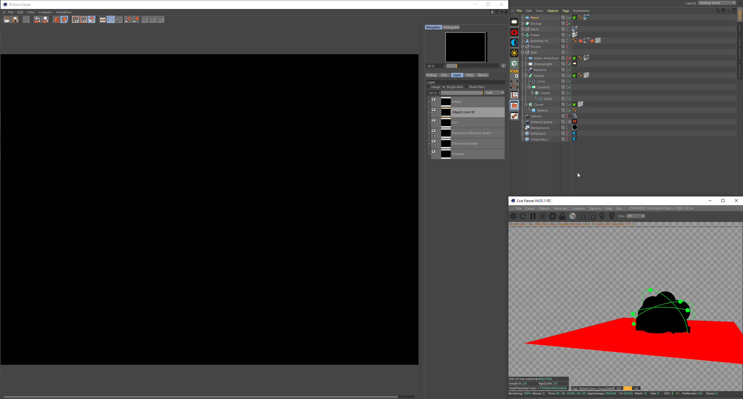

When exporting (in picture viewer) the info pass 'Object layer color' to an EXR 16 Bit (None compressed) file.
The object color layer results in a completely black layer.
Object layer colors show correctly in live viewer though.
						Object layer color pass doesn't export to EXR

Just tried 4.01.1, same result.
I attached a screenshot for hopefully some more information.
I did try a small test scene with just 3 cubes and that did export correctly.
So not sure it's a bug, most likely somethings wrong with my scene buildup?
Anyway I'll stick to 4.01.1 for now, as 4.02 gave me some crashes with resizing the live viewer as well.
Thanks for the help!

Send your scene pls?
Remains because you're using a method which is not supporting object layers/volumes/etc... It's deprecated. I'd be happy if you remove your report from bug section.joacwast wrote:Cleaned it up a bit to keep file size down, problem remains.
