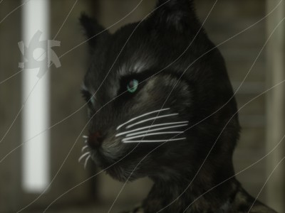

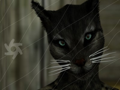

This version is working, thank you! Even hairs and foliage are visible in renderSighman wrote:I have posted a new demo based on Octane Render 4.02: Octane Render for Carrara DEMO 4.02LittleFisky wrote:So what can I do about it?EddyMI3D wrote:If you have running a newer version of OctanRender than 2.17 for the Studio plugin, it may not work with the Carrara Demo 2.1.7
