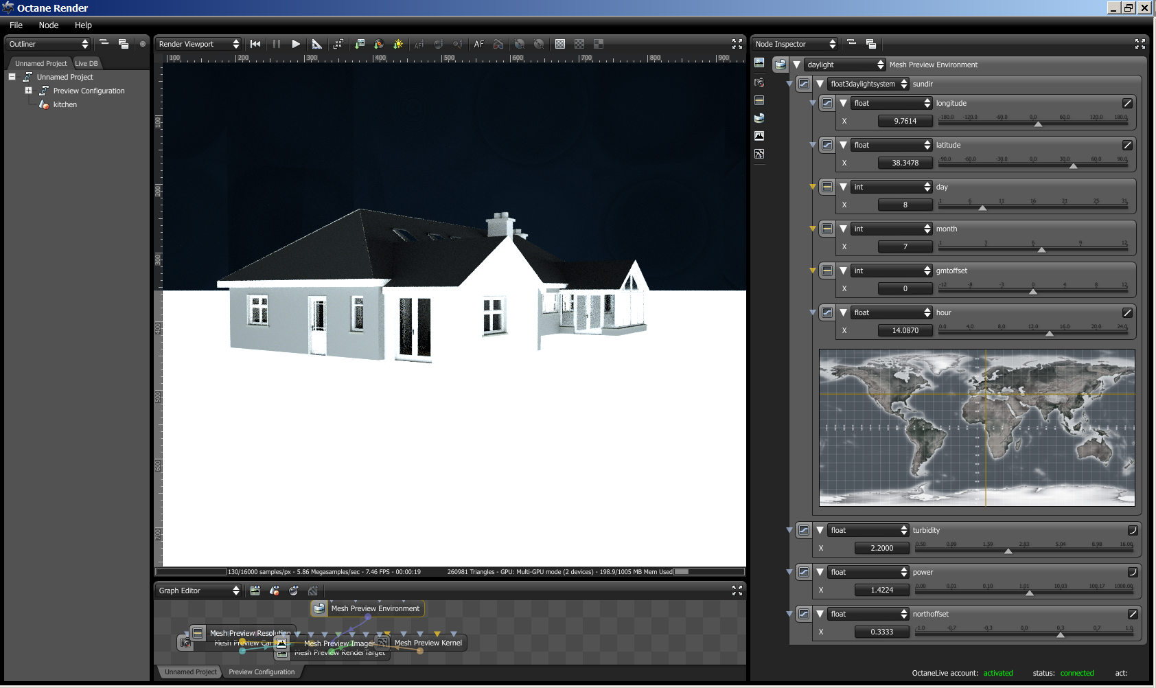

hi abstrax .
something seems to be broken with this release .if i export a scene from cinema 4d , i get this strange Sky dome mat.
i dont want ,and daylight in octane does not work anymore ?
cheers
Rico

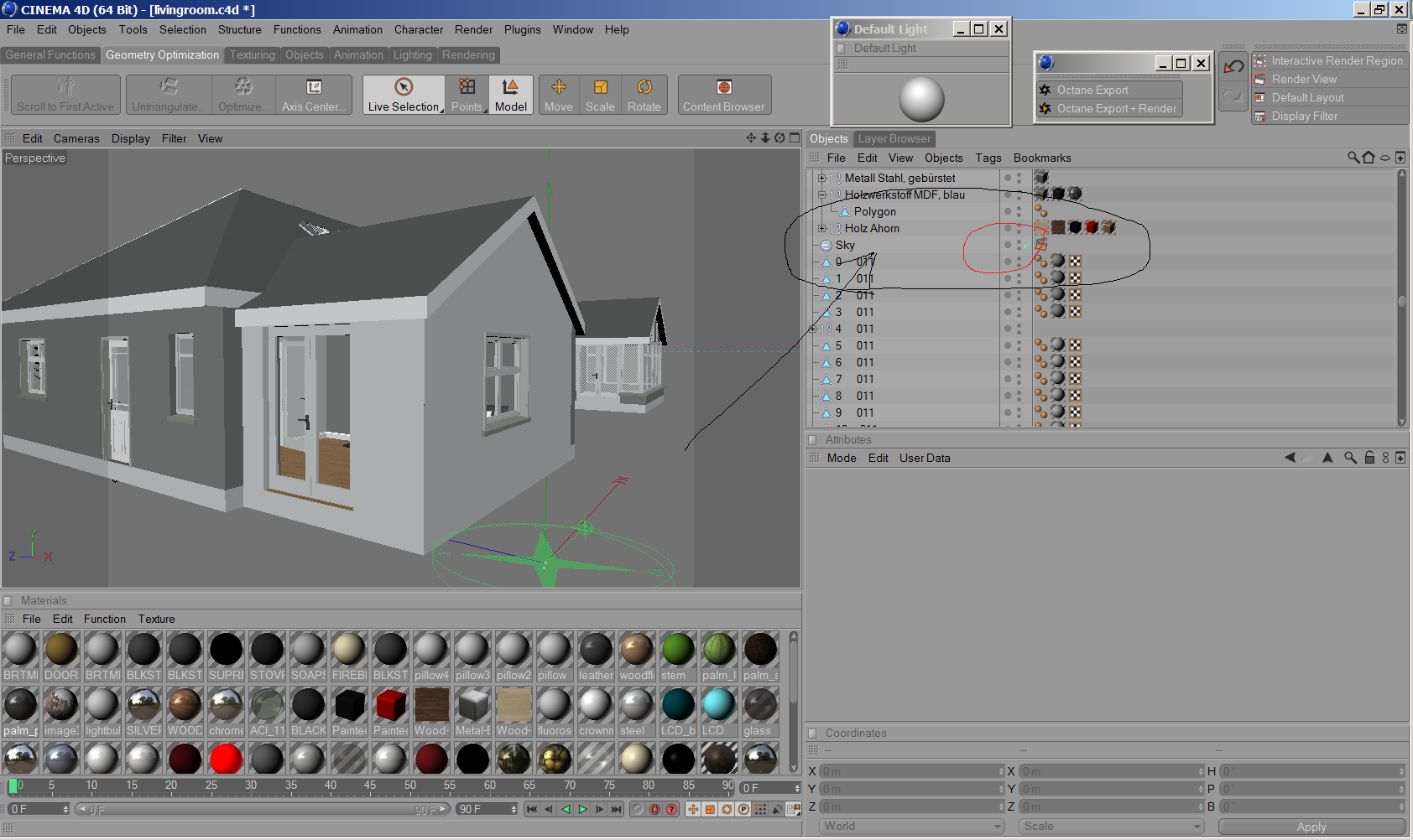

hi Marcus.
i did a view test , and it looks like if the Sky object in c4d is active ,you get that strange sky dome in octane
and the daylight is not working
attached a image of the octane render ,and the cinema 4d settings with sky active
the scene is to big to upload
cheers
Rico

abstrax
Posts: 5516
ribrahomedesign wrote:hi Marcus.
cheers
Rico
Ah yes, thanks for the feedback. Now I understand. The problem is that the Sky sky object consists of several (generated) light objects, including a sky dome which now gets exported. In Octane emmissive surfaces emit light only from the outside.
I can do two things here:
1. Flip the normals of hemispherical area lights.
2. Allow the Sky sky object be selectable as daylight object and if chosen, export only the (internal) sun light of it.
How about this?
Cheers,
Marcus
