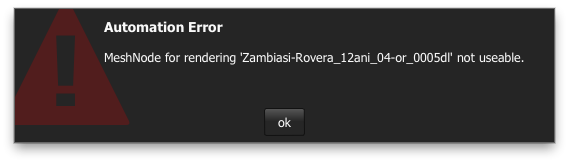

I've installed the new version for r11.5 but I have some problems with the workflow :(
I try to explain me with my terrible english, hope you can understand me :roll:
I export to Octane, make some materials and adjusting, save the scene, if I try to re-export from cinema all the modifications are gone :(
The only way for me is to save from octane changing the name of the ocs file. But when I come back to cinema and give it the new file name for connection and export again, I received an error message that the mash node is unusable, I click "ok" click on the mash node and octane start to render with no problem :?
With this error message it's impossible to lunch an animation render :(
ciao beppe

I investigate a bit more on my exporting problems and I find that the problem is only with octane 1.23.4, with the old 1.22b no problem at all.
It seams a problem with .mtl that override the material settings of the ocs file.
The only solution for me is to export obj/mtl only and then re assign it in octane, but it work only for stills I can't find a solution for animations.
How can I make an animation with emitters if is not possible to change materials?
Added camera-only animation export.
how does this funtion work?
I've try it but it make voxelization every frame just as before :roll:
ciao beppe

bepeg4d wrote:I investigate a bit more on my exporting problems and I find that the problem is only with octane 1.23.4, with the old 1.22b no problem at all.
ciao beppe
In short: It doesn't work in versions 1.23.3 and 1.23.4 because relinking of materials in Octane is broken in those versions. Unfortunately I don't know of a work around. I hope this will be solved with the upcoming version 1.23.5. Maybe Radiance, Nostromo or Brecht have more information.
