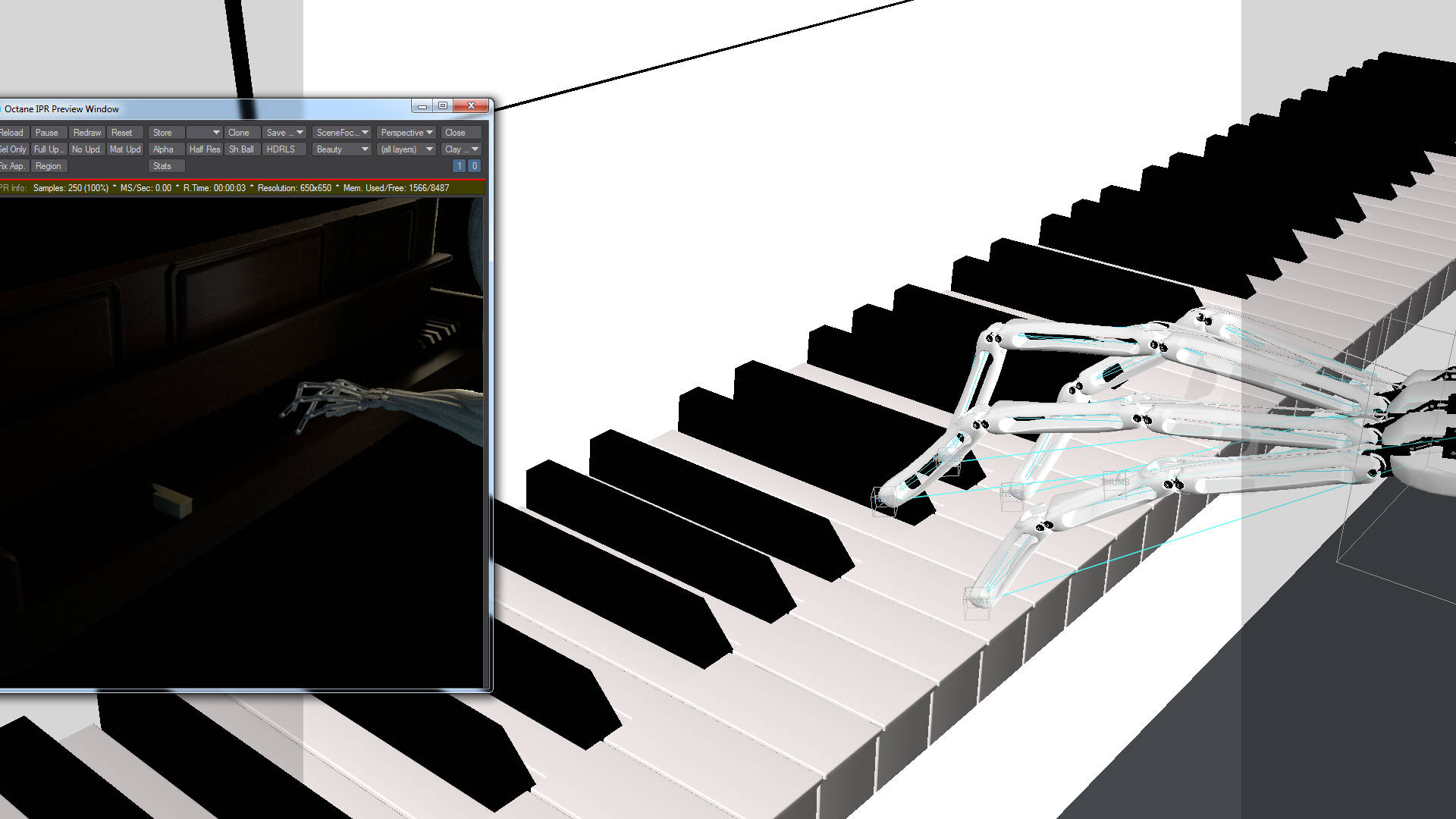

I've got a problem, a piano with many layers (keys will be animated so they all have their own pivot), everything is fine in LW layout but Octane renders the keys all over the place.
oh and the keys texture is also wrong in Octane but correct in Lw. (one UV only)
Marc Hermitte
If they are clones with its own deformations, try to disable the "Instance LW Clones" option available in the render target root node options panel. The instances are going to share the same base mesh and the same material, so this can be the problem.

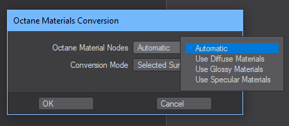

I am an Octane user that I use a lot in my works, the option material convert.
So I would ask the special combos that juanjgon would make an update and improvements to this special function.
Convert also to Metalic and universal materials.
Thankful.
