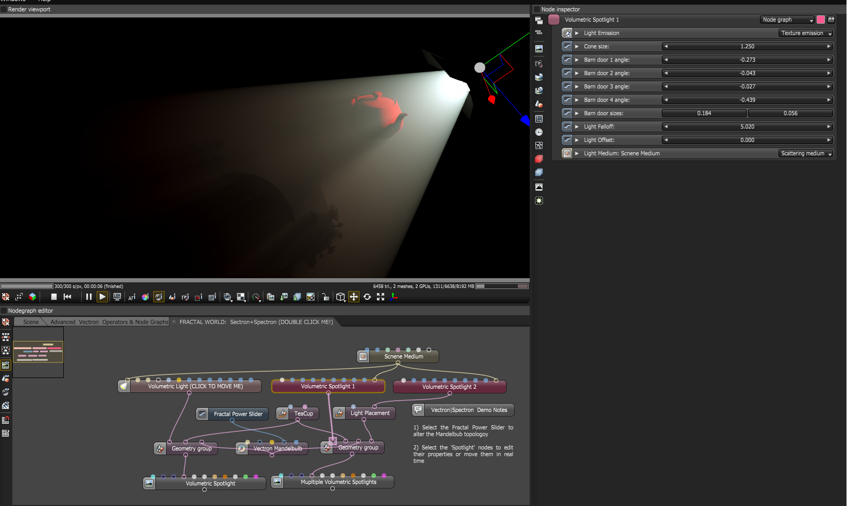

Thanks Juanjo! But How I can use that volumetric spotlight?
Thanks,
Saulo

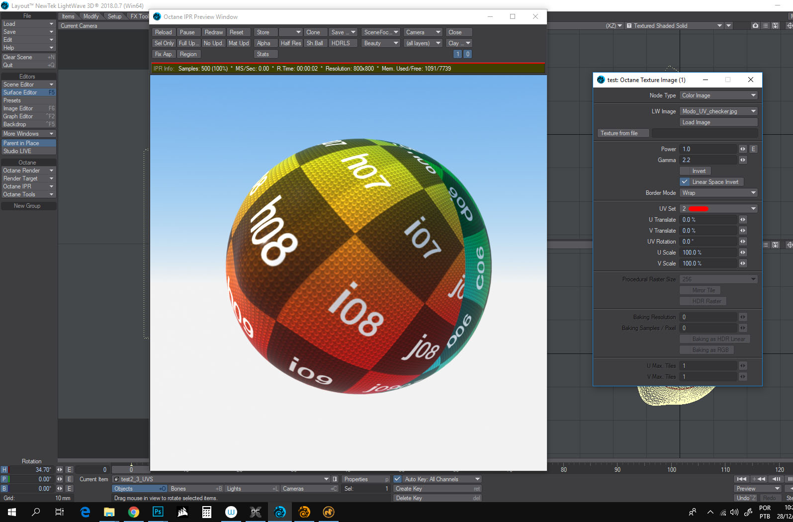

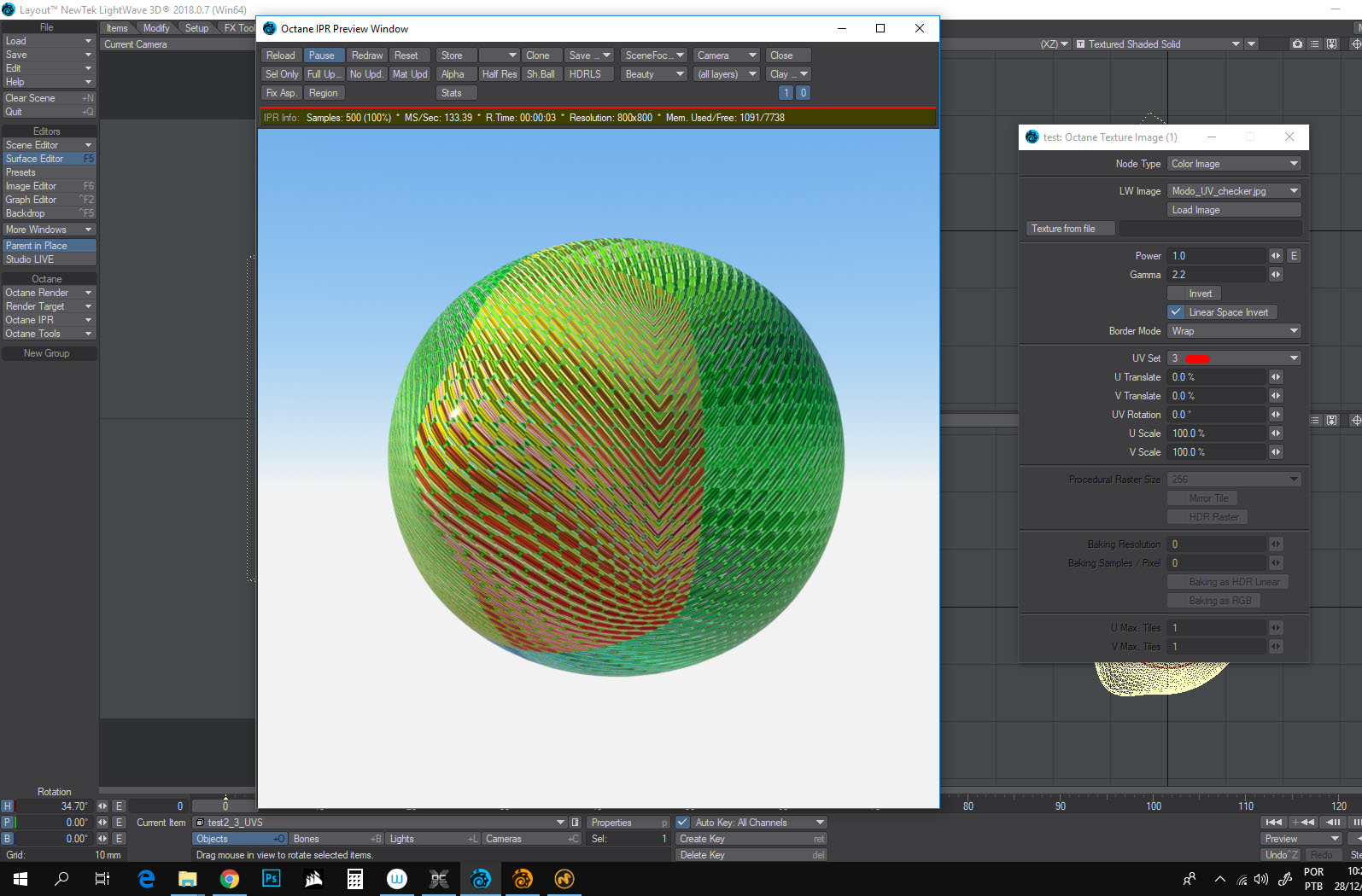

I see something strange when there are three UVS sets in a object. I am attaching the scene and 2 images to show the problem.
Thanks,
Saulo
BUG.rar
(2.05 MiB) Downloaded 324 times
juanjgon
Posts: 8867
Location: Spain
sauloarruda wrote:I see something strange when there are three UVS sets in a object. I am attaching the scene and 2 images to show the problem.
Thanks,
Saulo
Ok. Thanks for reporting this issue. It seems some kind of bug in the Octane core. We'll investigate it.
Thanks,
-Juanjo
