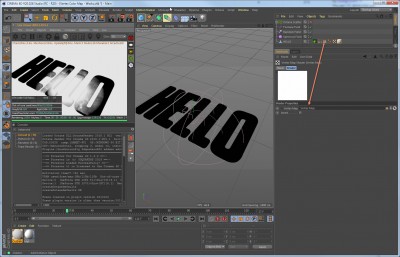

- FullHPetroL

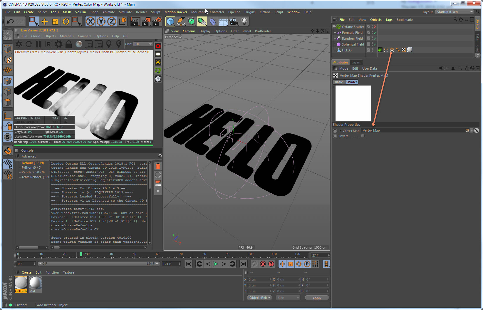

Hello!
I stumbled across a similar issue, while working with fields.
Creating animation via fields and VertexColorMap tag - works, while creating the same animation using Vertexmap tag - doesn't. Well it kinda works, for octane gets an updated animation frame each time I hit render, so I added an octane tag with "force update" enabled, but still - no animation on render.
Files attached.
Files attached.

It will work if you this. Only last tag is counted by plugin. Limit is one vertexmap/color tag for one object. I'll look to extend it as 4 vertexmaps+2 colormapsFullHPetroL wrote:Hello!

Yaaaay! it works! Thanks!aoktar wrote:It will work if you this. Only last tag is counted by plugin. Limit is one vertexmap/color tag for one object. I'll look to extend it as 4 vertexmaps+2 colormapsFullHPetroL wrote:Hello!
