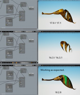

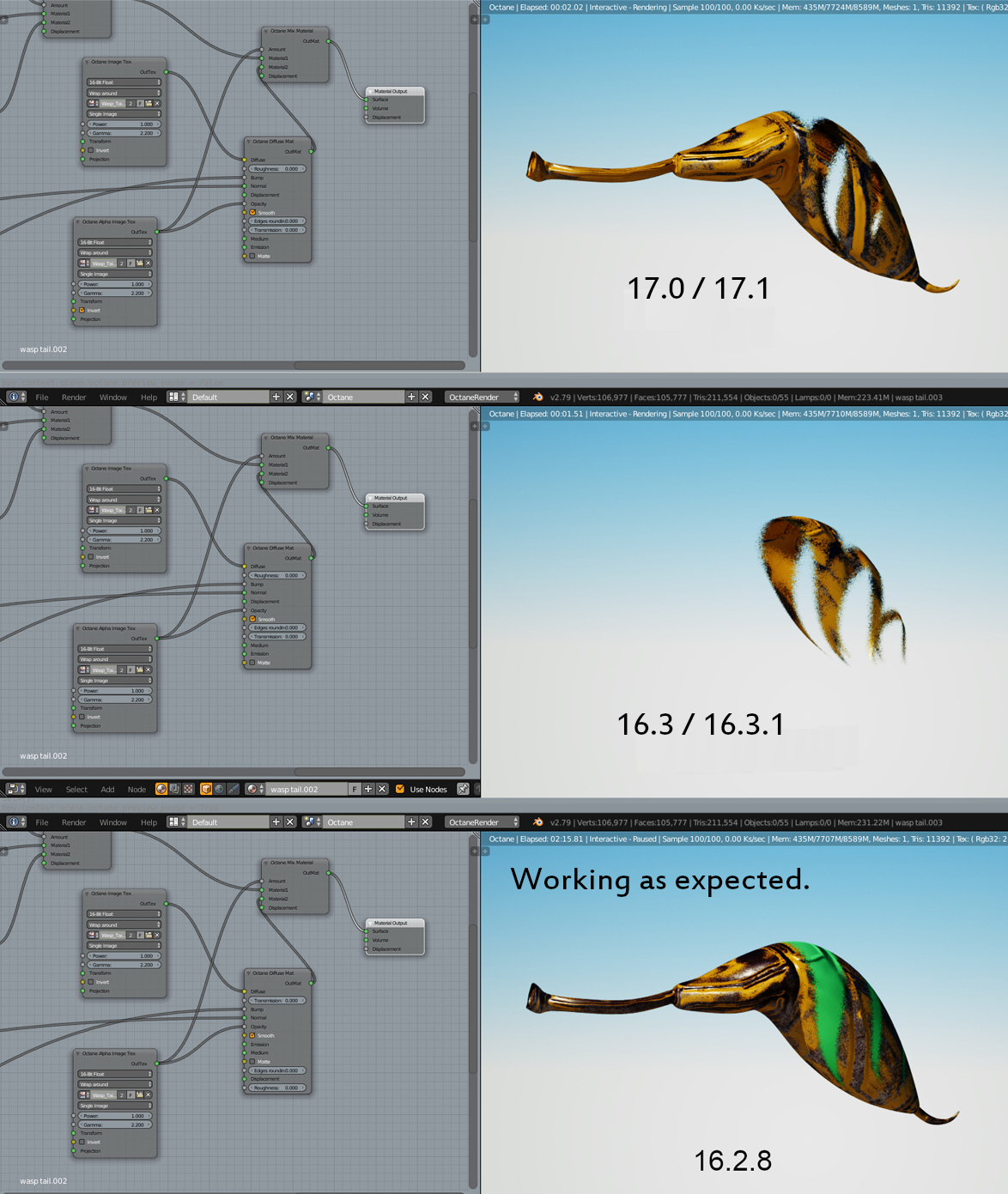

Hi, I've been using this node set up for ever to do over painting and decaling
but since 16.3 and up I'm getting the results shown. Is this still an issue with
the Octane Mix Material node or maybe the Octane Alpha Image node?
Still an issue with material mix node or alpha image node

In standalone (v4 and 2018) it works as expected. I latest Test Blender plugin it also works as expected but it is inverted :/

Hi dreif and J.C,
Thanks for your reports and sorry for the inconvenience.
In current blender builds(16.3.x and 17.x), we fixed a legacy bug in mix material which has been there for years.
Basically previous builds inverted the order of mix material inputs and now the order is correct.
In the next build, we will fix the backward compatibility bugs so you don't have to change your scenes manually.
If you want a quick patch in current builds, here I wrote some script to help you invert the inputs automatically. It works fine in the tests. Please let me know if you have any questions. Thanks!

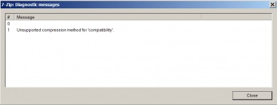

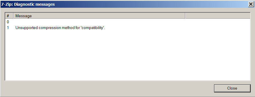

This is not working.
File was saved in 15.3.4 then opened 16.3.1 and 17.1 with updated compatibility.py file. After opening the order of mix material inputs is not inverted.
