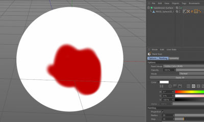

you can bring vertex colors from Zbrush to C4D by using the FBX Export/Import plugin in Zbrush. Check vertex color checkbox on fbx import to c4d.
Edit: I see Octane can read/bake the vertex color shader from c4d...so no problem to render it with Octane
