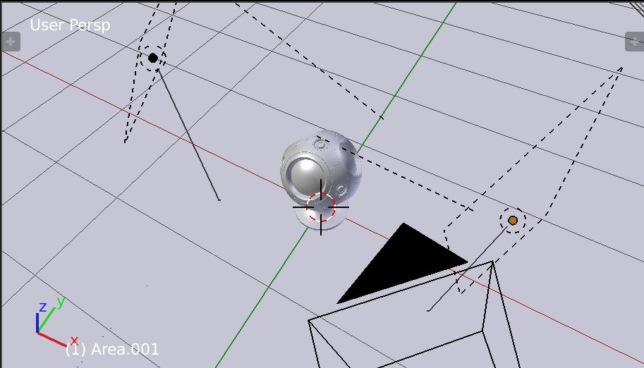

Hello,
A simple scene with a plane ground, a sphere and 2 area lights.
When I enable daylight, it sees the area lights shapes and casts shadows of them. Any way to disable that? Thanks.

Looks like a bug to me.
Temporary solution for this is to set area light Diffuse material opacity to 0 and turning on Transparent emission in emission parameters.

There isn't any "Area lights" in Octane, they get converted to meshes (planes).
And that's why they have shadows.
But that might be one for the "wish list"/feature requests that:
  • Area lights by default don't have "Shadow visibility" set to false (just as "Camera visibility" is set to false by default)
  • There's an "Shadow visibility" option for area lights (this exists for meshes in the Blender UI, would be nice to have it for area lights as well).
Personally I tend to just stick with planes/mesh lights, but area lights can be handy and in some ways "easier" to work with..
