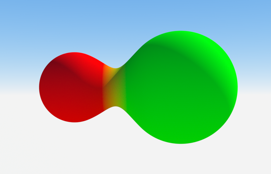

The main change comppared to 2018.1 XB2 is the way how OSL code of procedural geometry returns values: The output value is now of the Octane-specific type _sdf, which is defined as:
Code: Select all
// struct for vectron shader networks (used for sdf inputs, and outputs).
struct _sdf
    int   objId;
    int   matId;
    float u;
    float v;
    float dist;
This way vectron objects can provide the necessary information required for shading. Please have a look at this simple example where a vectron node creates a blended union of two input vectron nodes:
sdf-union-material4.orbx
(71.17 KiB) Downloaded 552 times
(EDIT: The original example scene got replaced since there were some issues with it like the one that calus reported.)
For completeness here is the previous example scene updated to the new SDF interface:
Fun_With_Vectron.orbx
(16.02 MiB) Downloaded 893 times

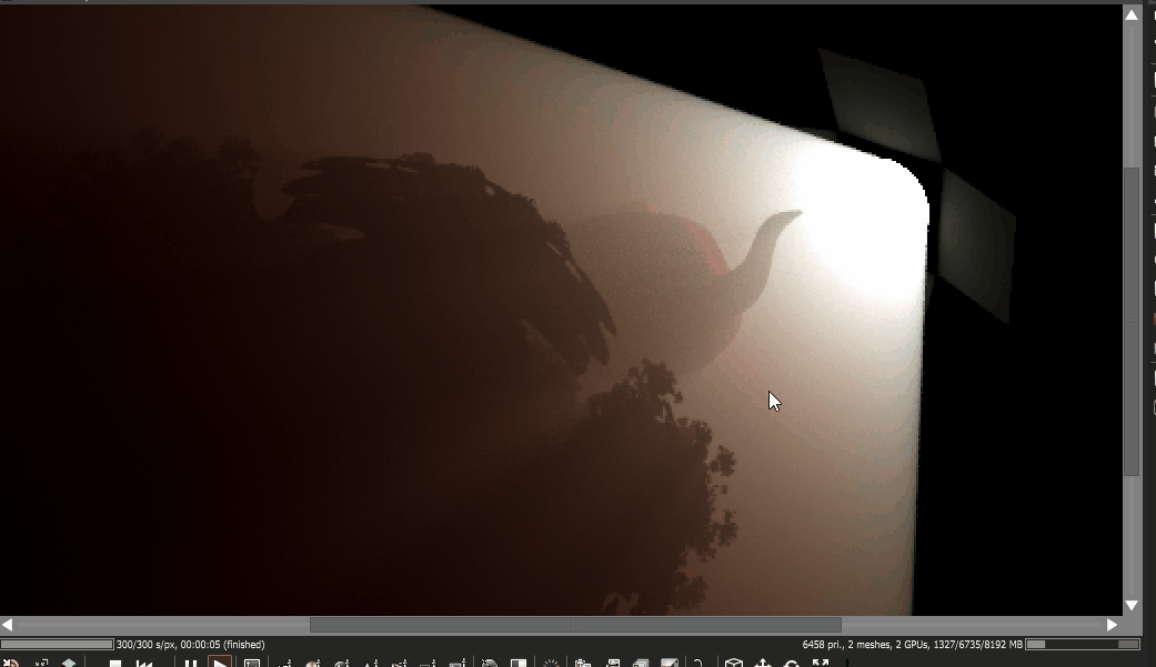

Are you going to fix this? When the camera is inside of volumetric light.
GPU: 2x4090; 3ds max;
Behance portfolio; Handmadefont.com;

The sdf-union-material.orbx example have a mistake In the unionRound function, swaping the SDF input in the result:
a.dist - b.dist should be b.dist - a.dist
sdf-union-material2.orbx
(72.19 KiB) Downloaded 425 times
