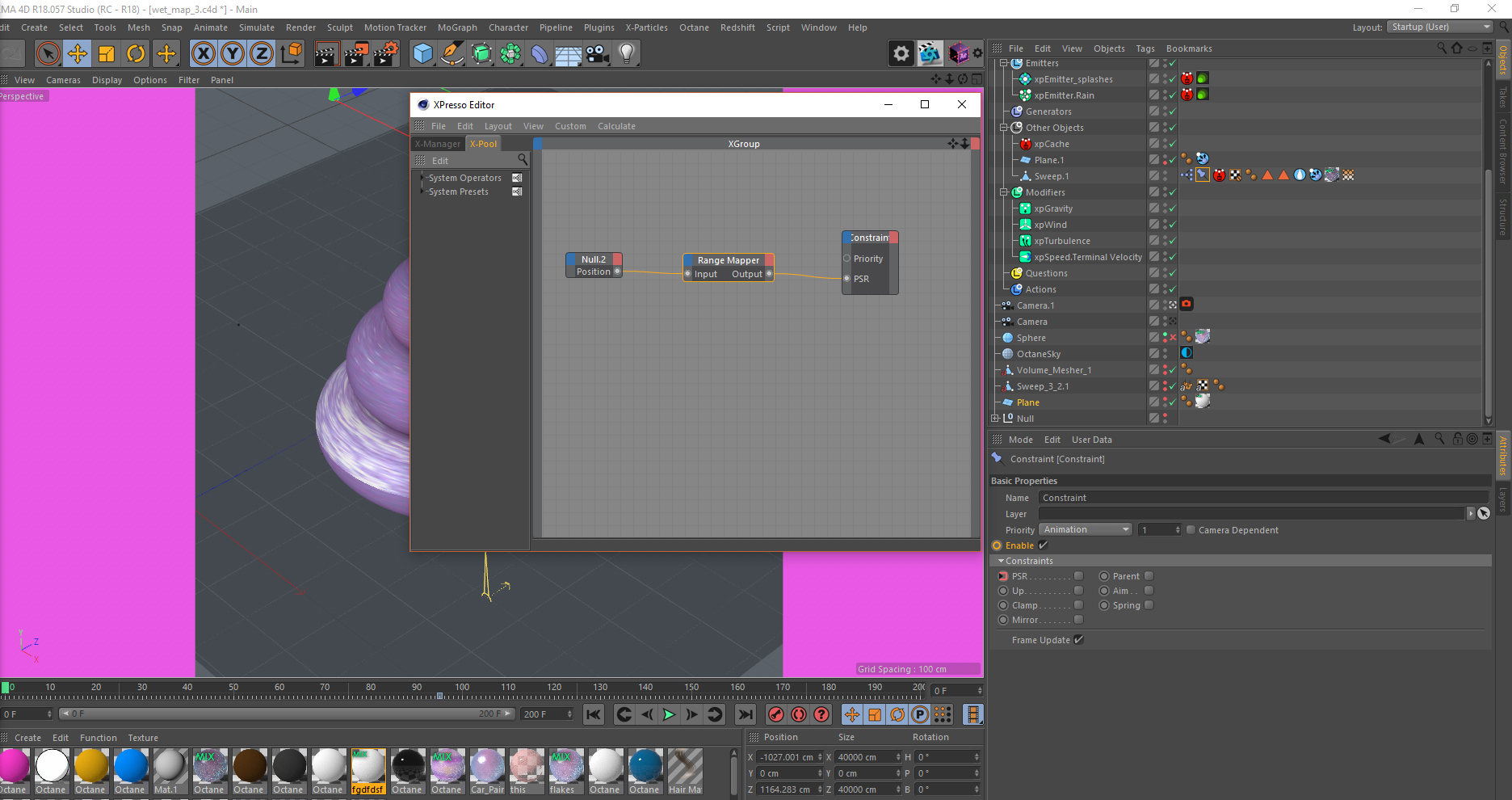

Hi ya I managed to find a way to do it.
I add constraint tag and just basically animated its enable/disable parameter with expresso
I attached screenshot
