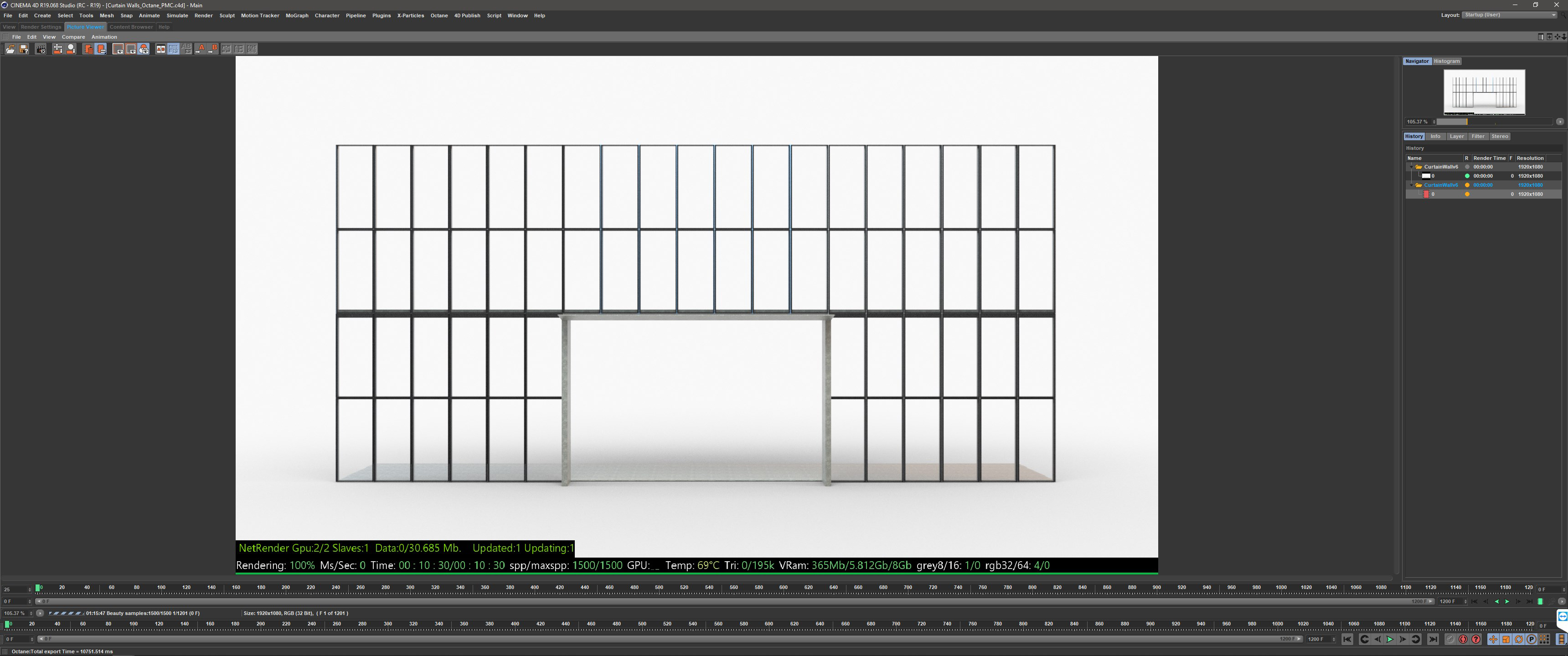

Is anyone else having rendering issues using PMC, which renders frame 0 and does not finish the render?
Attached is what I am getting.
Posts: 16068
Location: Türkiye
GSMATTAnimation wrote:Is anyone else having rendering issues using PMC, which renders frame 0 and does not finish the render?
It looks like waiting for long time at same frame. Have you checked any render passes and looked to Console for render log?

GSMATTAnimation
Posts: 8
Joined: Mon Jul 10, 2017 11:12 am
Location: Oxford
I had not checked the render log but I did check the render passses. Unfortunately I had changed some setting to get the job rendering, so the old log is gone.
I had not set up any beauty passes. I did however have the AI Denoiser on.
Turning that off now renders the frames fully and moves onto the next frame. Could be a glitch with PMC and the AI Denoiser maybe?
