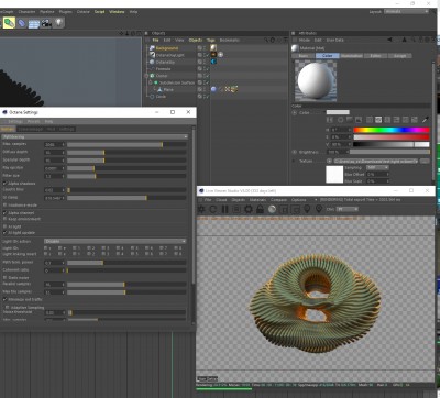

Here is the set up.
Tijack
Posts: 18
Joined: Sat Sep 02, 2017 11:23 am
OK,
I needed an octane Camera with enable camera Imager.
Thanks :)
