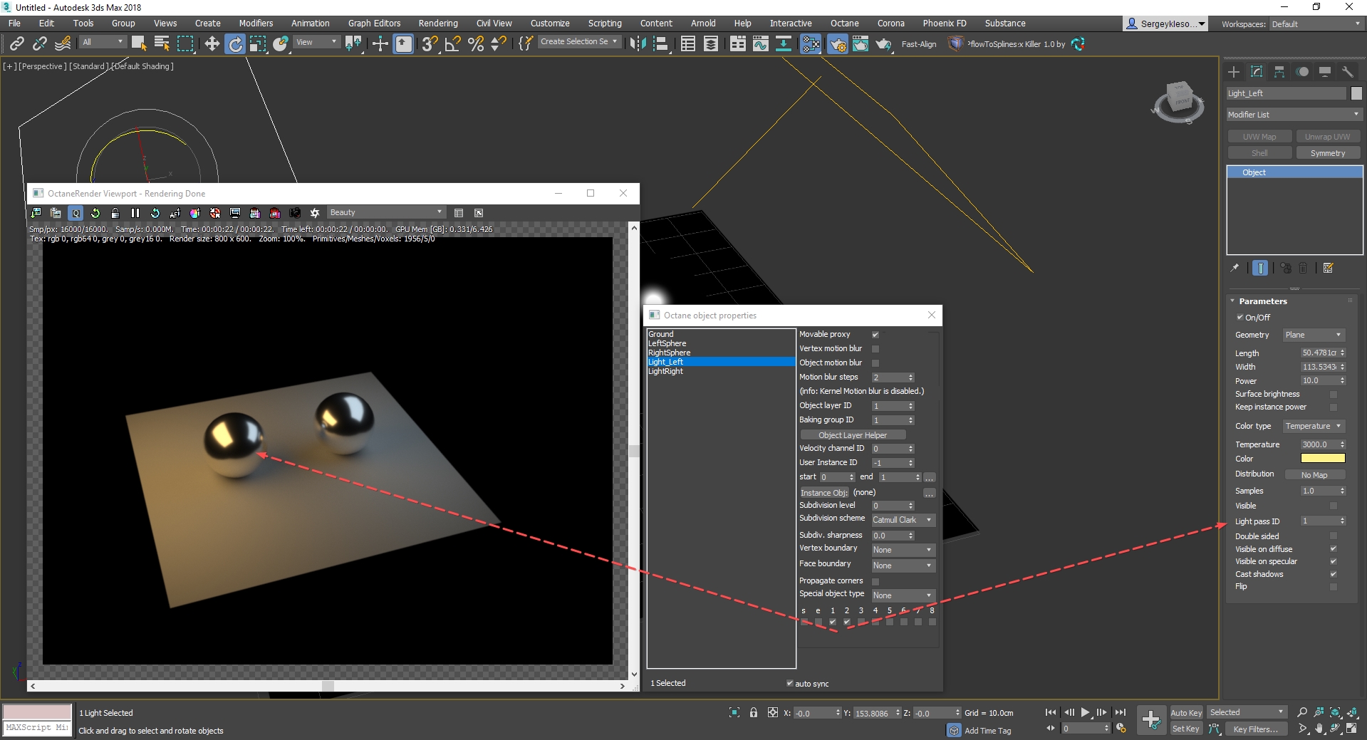

Can you now create comprehensive tutorial on how to use light linking feature and what is Object Helper?
I have a test scene with two lights and two spheres
The spheres are chrome and I want to have one sphere with reflections of both light emitters and second sphere to have reflection only from one emitter
I've setup light ID's numbers in OctaneProperties but this has no effect on the scene at all
I can only globally turn on and off specific light ID's in the Kernel Tab
Thank you

Your setup looks right. You may have to not just restart a render, but click the blue arrow to force all objects to update. For whatever reason, light linking requires this as Octane doesn't notice of those boxes are checked until you force it to update. Again, restarting a render isn't enough.
