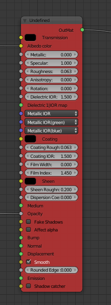

I recently tried the 3.08 update and my Universal Shaders have become "Undefined".
Tried to revert......still undefined. (see attachment)
Entering Shft+A, and looking for the Universal Shader under Octane Shaders......nothing. No there there. Just the Octane shaders prior to the Universal.

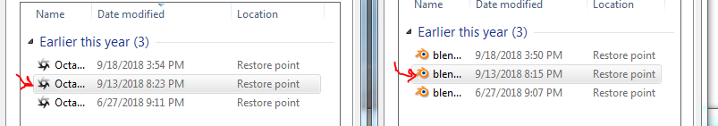

Here is what I have been able to do to re-activate the Universal shader:
Right click on the .exe files for both the ORserver and BlenderOctane, and launch from a restore point.

What I cannot determine is what versions of BlenderOctane/ORserver I am running. The Blender splash page only reveals 2.79b.
Is there a way to determine, when running, precisely what versions I have reverted to through this restore point option?

Universal shader is only available in v4+
Opening projects in v3 with universal material will end up with undefined node in material editor.
