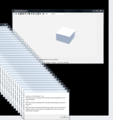

One screenshot after Rhino is opened and Octane started first time (anything looks fine) and than I pressed paused at the viewport and opened a new empty file (error).
Sorry, I am very confused now. You said you were getting a black viewport - however the viewport looks OK in the above images and you are getting another error. Can you pls clarify what is happening?

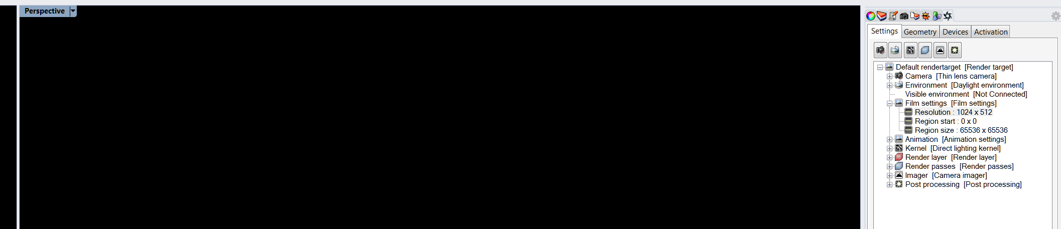

I mean all Rhino viewports are dead, only complete black. (You can see it at some of my screenshots.)
I see - sorry for my confusion. This looks like a Rhino or Nvidia graphics card issue. Have you tried turning off rendering for the graphics card responsible for your display? And I suggest checking the Rhino->Rhino Options->View settings to see if there are any setting wrong. In particular, you probably want to turn OFF Use Advanced GPU Lighting.

the Advanced GPU lighting was off already. I disabled my display card for rendering now, but the problem is still there.
I found, if the viewports are black, than I can blind draw a box and start a rendering. So, it looks like the Rhino display pipeline is crashed if Octane was enabled during loading a new file.
As a test, try rendering on the other card. Rhino can sometimes use a different card to your display adapter for it's OpenGL processing. It is worth testing.
This definitely sounds like a Rhino or Nvidia driver issue to me. You are the first user to report this issue. May I suggest posting it in the McNeel forums to see what the Rhino devs say.
