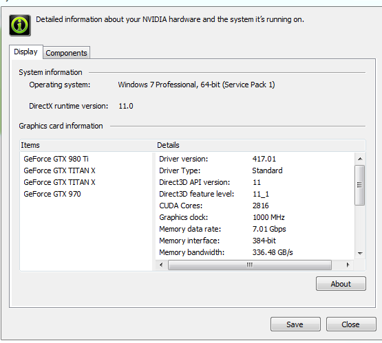

Now I see, you got this information from the hardware manager.
But have you installed the complete bundle version 416.94.
Or just the driver?
The CUDA driver is installed separately.
When you rightclick on the blank screen, you can open the NVIDIA Control panel.
At Help you can get System information and there Components.
There you have all installed drivers.

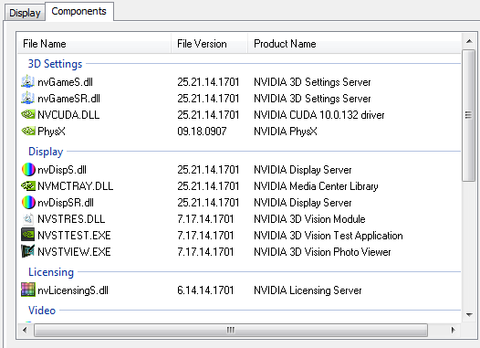

So after hours of cleaning and rebooting,...using ddu, failing, with system restore launching on its own on the reboots, I did seem to
clean a bit.
But as you note, Device Manager still shows the old driver. So after leaving overnight, I woke up to a non-system restore reboot and, lookee...
So I am ok?
I am not seeing a separate Cuda download, other than the Developer's Kit, on the Nvidia site.
And my Device Manager still shows 25.21.14.1701 for the Video Cards.
What is your Cuda version.
I just came across this : https://developer.nvidia.com/cuda-toolkit-70 , which offers an independent download of Cuda, but because it is nested in the Toolkit area, I am worried I might be getting
into something above my pay grade.
