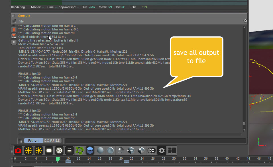

Could you please capture console output from your tests and put here? So we can check times and invistigate.
