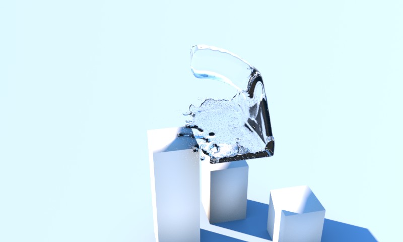

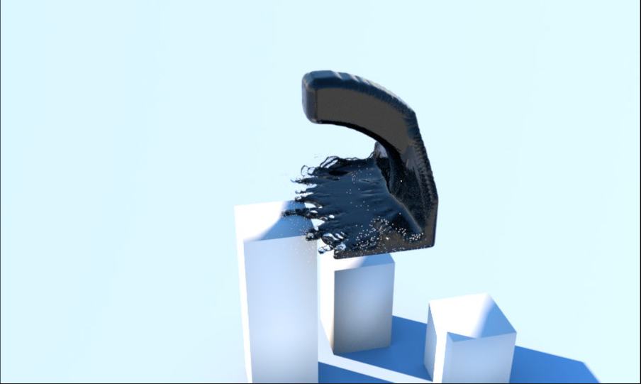

I am trying some fluid dynamics inside blender...
But when I compare the rendering from a specific time with the animation the look is totally different:
Still image from fluid simulation:
And this is a screen shot from the animation:
Both images are taken at frame 60.

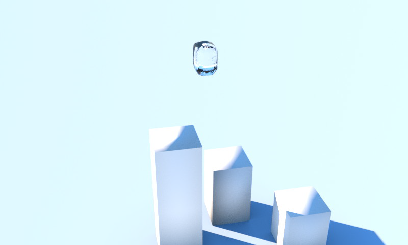

Really weird...first two frames are correct, then the water material gets dark and stays that way...
