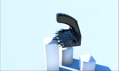

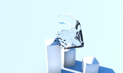

But when I compare the rendering from a specific time with the animation the look is totally different:
Still image from fluid simulation:
And this is a screen shot from the animation:
Both images are taken at frame 60.
Rendering the animation in Cycles looks correct like the still image.

Wrong animation rendering with Octane for Blender:
https://youtu.be/L51M3ASxoAc
Correct rendering of animation with Cycles:
https://youtu.be/Pn_uVDM4H3E
It looks to me like OctaneRender always uses the maximum mesh extent of the fluid
and doesn't take into account newer smaller mesh dimensions.

Okay...got it....seems the Flip Fluids demo plugin doesn't auto-detect Octane as the commercial version does...
So you need to set the Mesh to "global" for the fluid...
But black frames in animation rendering still persist...
