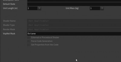

Something seems to have changed with the "Octane Material Builder", previously I could spawn my own HDA's inside it. I no longer seem to be able to do that. Earlier versions of V4 it worked but not anymore, and they still work fine in V3.
Please advice.

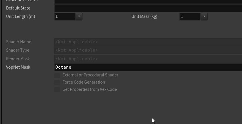

Do you have "Octane" as a Vopnet Mask in the HDA? You need to define Octane there to avoid problems while working with several renderers inside Houdini.

No with 3 I just used 'Surface' in the Vopnet Mask and it worked fine in v3, and worked with earlier versions of v4 as well. Is there any chance that adding 'Octane' as Vopnet Mask might not work with v3 since it seem to have changed in the newer v4 builds ?

This change has been made while working in the H17 plugin version. Now you need to add "Octane" as vopnet mask in the Octane HDAs, as expected (the same happens with Mantra and all the other external renderers).
In H17 the old trick of checking inside the HDAs if there were Octane vop nodes to enable it as Octane HDA was impossible, and in any case, this trick was really slow in the pipelines managing a lot of HDAs (and not standard at all in Houdini), so all this code has been removed from the plugin. Defining the proper vopnet mask for the HDA is the way to go ...

Thanks, yeah I was mostly a bit stumped since it used to work and suddenly stopped. But I have updated the HDA's with the 'Octane' vopnet mask now and they work and from what I can see it works in v3 and v4 and both H16.5 and H17 with the 'Octane' vopnet mask so I am all good again =) thanks!
