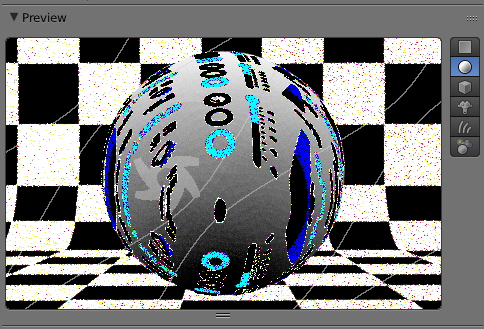

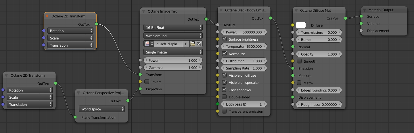

Hmm..this C4D example looks like a way to go...though there are several settings which just don't exist in the blender plugin... https://www.youtube.com/watch?v=3IVCXIuHDeo
I get something projected but makes no sense at all....
Guess I have to continue to use slower luxcore renderer...

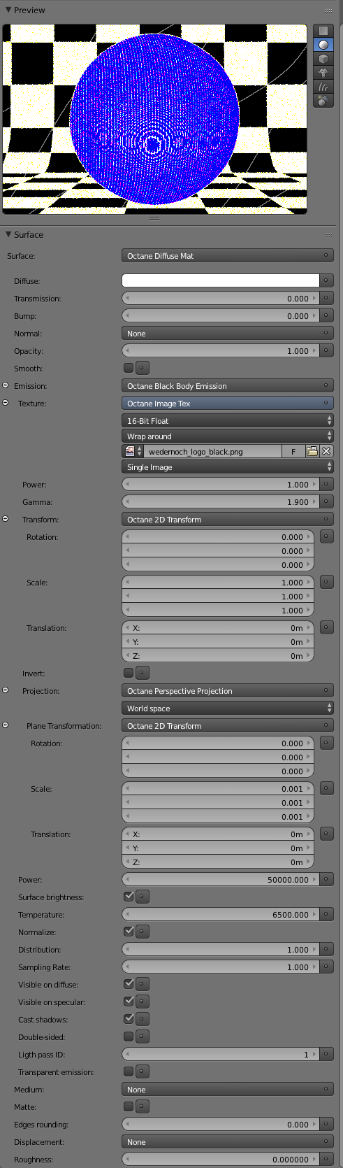

Starting over again...set the emitting plane a little bigger so I can see the texture..
When I set the border mode of the texture to "wrap" the texture is around the same size as the plane and it emits light...
As soon I set the border mode to "black" the whole scene is dark...
