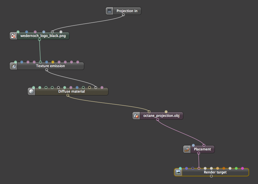

Tried now a quick setup in standalone version though I never used...but seems to work on first try...
the mesh object is still too large though as the projected image is blurred...
Trying then to map all settings back to blender scene...

It just does not work with the same setup in blender as in the standalone version...
The preview is shown correctly with the projection...but just dark in the render output...
So what is different using the blender octane version compared to standalone?
