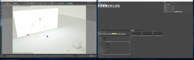

Hey
I find this issue with light size doesn't match with the viewport.
using c4d R19 lastest , latest GPU driver, and tried both latest octane V3 and V4 seem light they both have that problem.
my scene unit and display unit is mm.
https://drive.google.com/file/d/1NZQK_3 ... sp=sharing
https://drive.google.com/file/d/1mXO82J ... sp=sharing
Cheers.
OctaneLight size don't match with the view port
C. RAM Capacity (i.e. 6 GB)
Hey aoktar,
Thanks for the quick reply.
what I did to fix it, saves the file called new.c4d as a cm unit file then when I re-open it and it's normal again.
I have to change the display unit in project setting as cm,unit in preference's unit setting has to be cm.
maybe that there is a problem with that old new.c4d file ( attacked bellow, hope it might help)
https://drive.google.com/file/d/1BQB_p7 ... sp=sharing

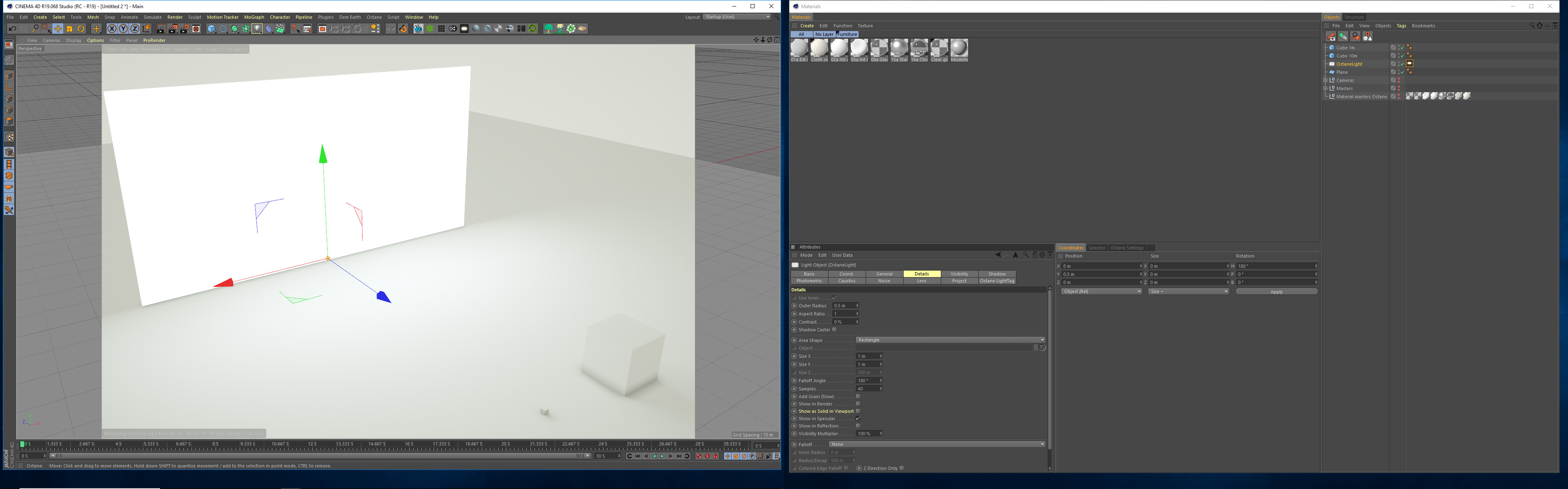

I appear to be suffering from the same issue. a couple of days ago all Octane lights are rendering as 1000x bigger than they are in C4D. This is happening to scenes that are both new and old, so it's not in the scene file, it's in the software. It is presenting me with a HUGE problem as the only fix I have right now is to scale every light source by .001 to get it working right, which means modifying every project I am working on as a bug workaround, which will bite me in the arse when this bug is fixed.
I tried reinstalling Octane + plugin, deleting preferences, etc..
My scenes are all in metres. The attached image shows a 1m sized Octane light - notice it is selected. But notice how the actual light showing is MASSIVE in comparison. You see two cubes in front of it. The smallest is 1m, the same size as the light, and the second is 10m. So it looks like the light is rendering out 100x bigger than reality.
I installed C4D R20 (I was on 19 until an hour ago) and have the same issue, so even a fresh install is causing the problem on existing files. Creating something in R20 from scratch using the template that shits with it comes up with no issue.
HELP!!!
HELP!!!

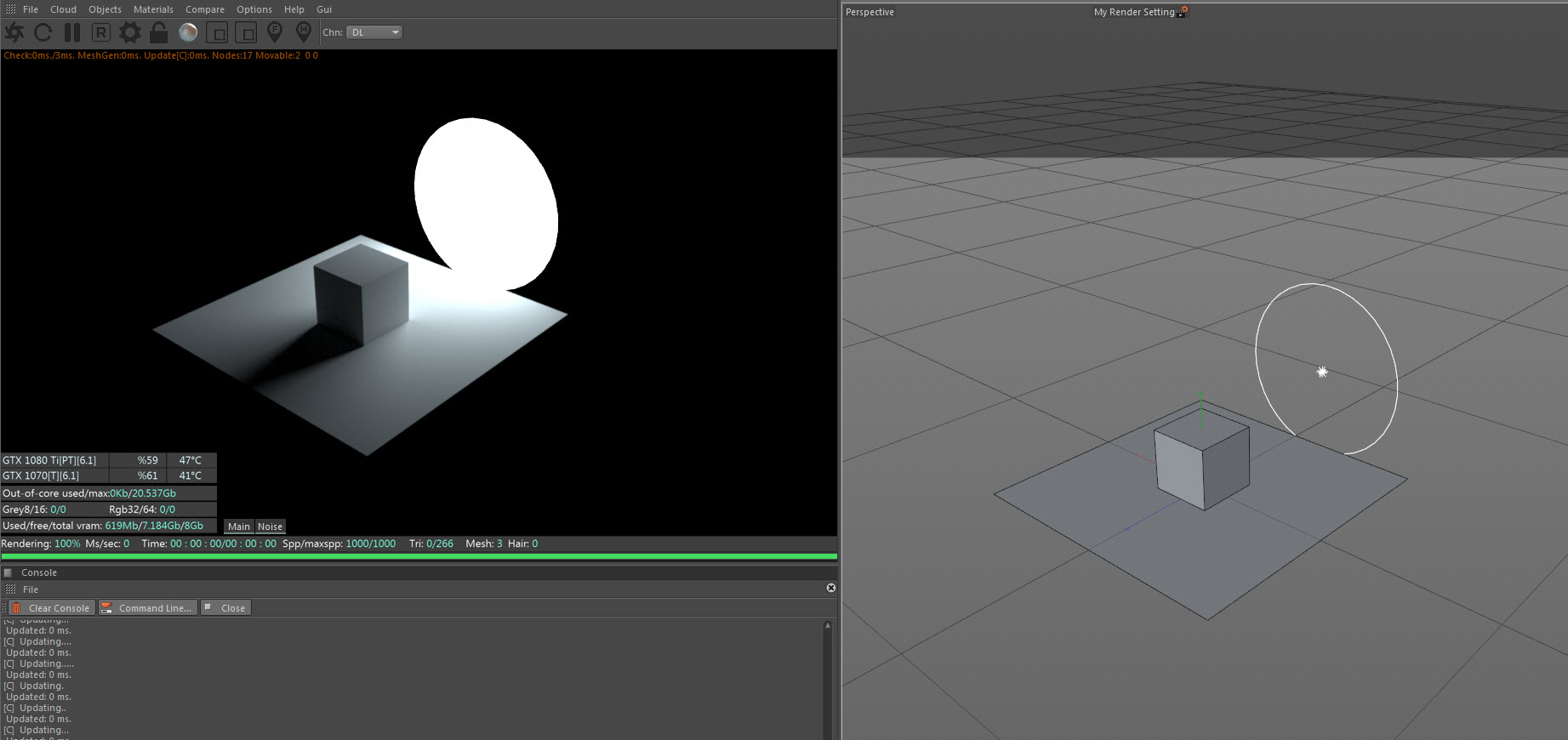

Here it is, I made it just now. The Octane light is rendering 100x bigger than its real size.
