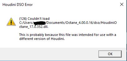

Getting these error messages with Houdini 17 and this Octane Render plugin. Do you have any idea why?

Hmm, not sure. Does it work with Houdini 16.5 on this same system?

Hi Juanjo,
I'm not sure with 16.5. Only tried with 17.
What are your recos on managing the houdini.env file when you want to jump from 4.0 to the production build?
Does one set up 2 houdini.env files or do you have to type that string in everytime?

Houdini is going to read the environment variables from the houdini.env file, but it is also possible to create a script to define these variables while working with multiple Houdini or plugin versions. This is a good tutorial about it: https://jurajtomori.wordpress.com/2018/ ... variables/
About your problem with the Houdini 17 plugin, you should check if the PATH variable has the right path to the plugin "bin" folder, and of course, if this system has the correct drivers and configuration to run Octane, perhaps installing also the 4.00 RC6 Standalone version to see if it works fine.

Thank you.
I did two things. 1. Update the standalone to 4.00. 2 I did miss the "/bin" in the path string.
Appreciate your help.
Seems very quick!
