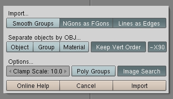

What settings do I have to use when importing the model from Archicad to Blender? I keep getting an error message about not being able to import the model.
- Attachments
- Blender import obj.jpg (35.71 KiB) Viewed 5890 times
