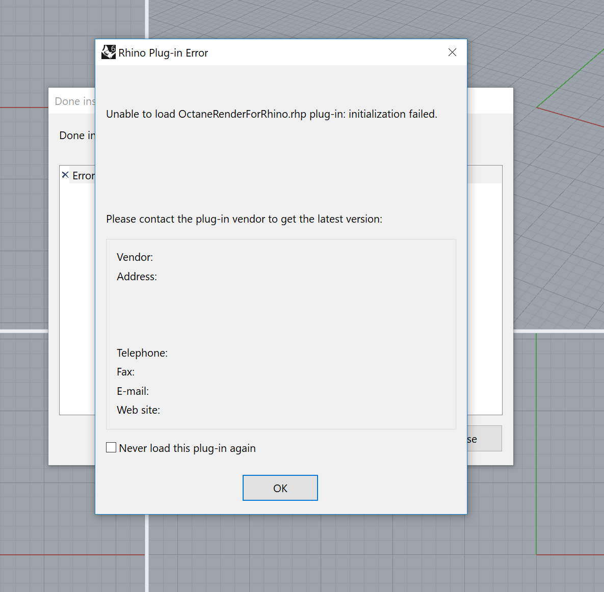

I cannot install the octane demo for rhino 6 ....
anyone encounters the same problem?
The error message says
Rhino Plug-in Error
"Unable to load OctaneRenderForRhino.rhp plug-in:initialization failed. "
I have uninstalled Rhino 5 from my laptop, and there should be nothing puzzling for the installer.
Anything I can do about this bug ?

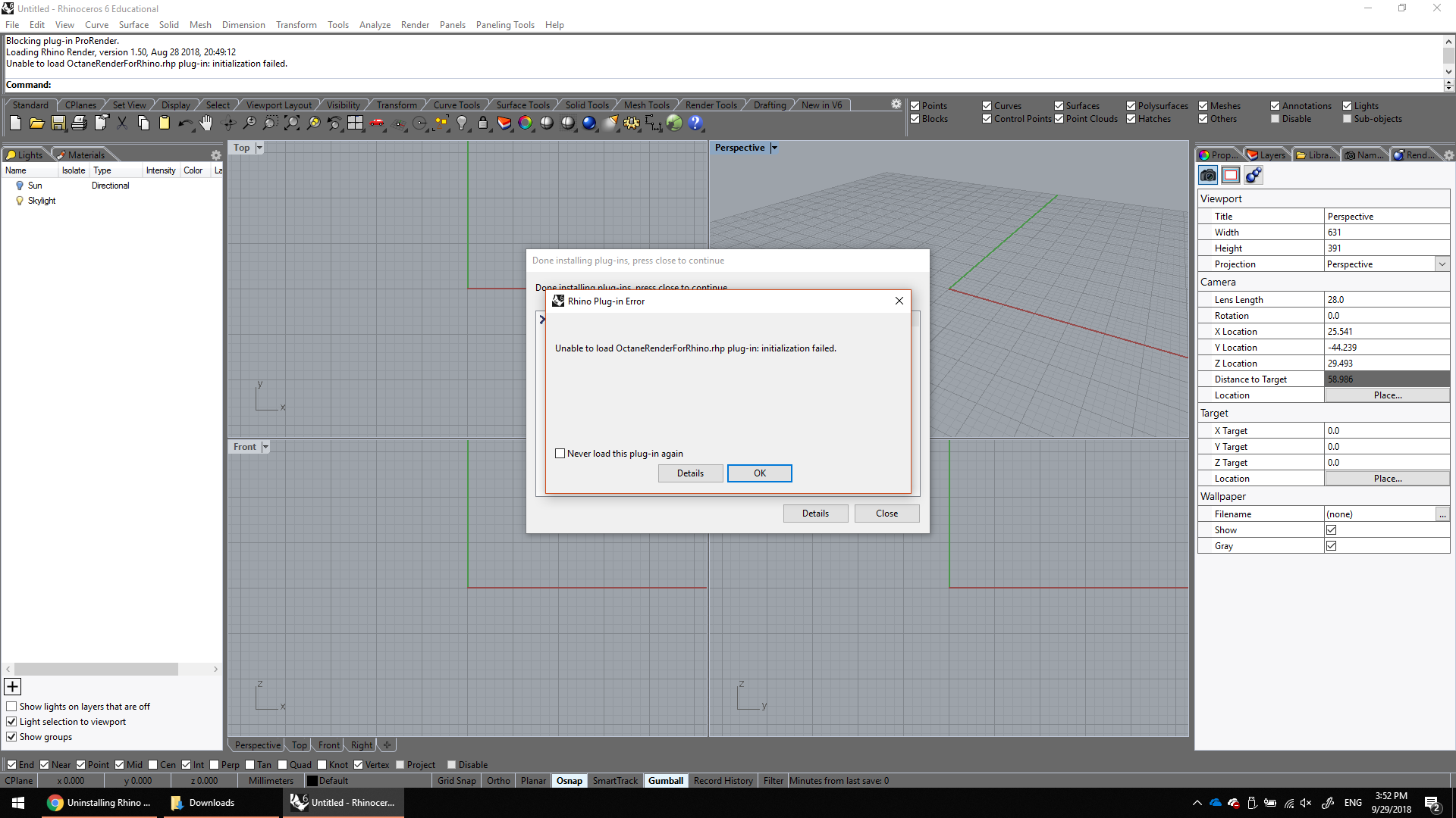

Hi Paul
I'm having the same issue but with a license.
The details aren't saying much....
Thanks in advance
