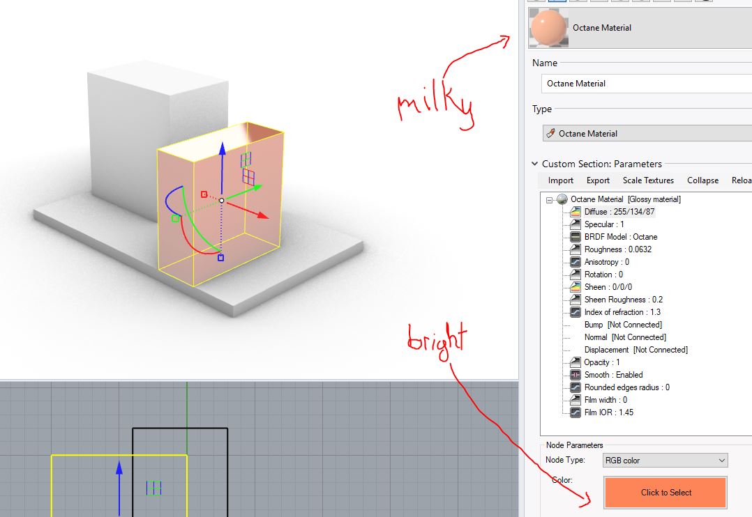

Hello Paul,
I couldn't find the Octane 3.08.3.98 Plugin for Rh6 but tried the Octane 4.00.0.98 for Rh6.
The Material Color is now shown in the viewport. That is great.
The only thing is that the material preview ball looks a bit too milky. It seems the color management is different for that. Can the material ball color correspond 1:1 to the diffuse color box?
The other question I have is the appearance of the color in the viewport. Rhino makes it quite shiny and soft color while octane shows it really strong as setted up.
Is it possible somehow that the material representation within the Rhino viewport comes much closer to the octane material setup?
