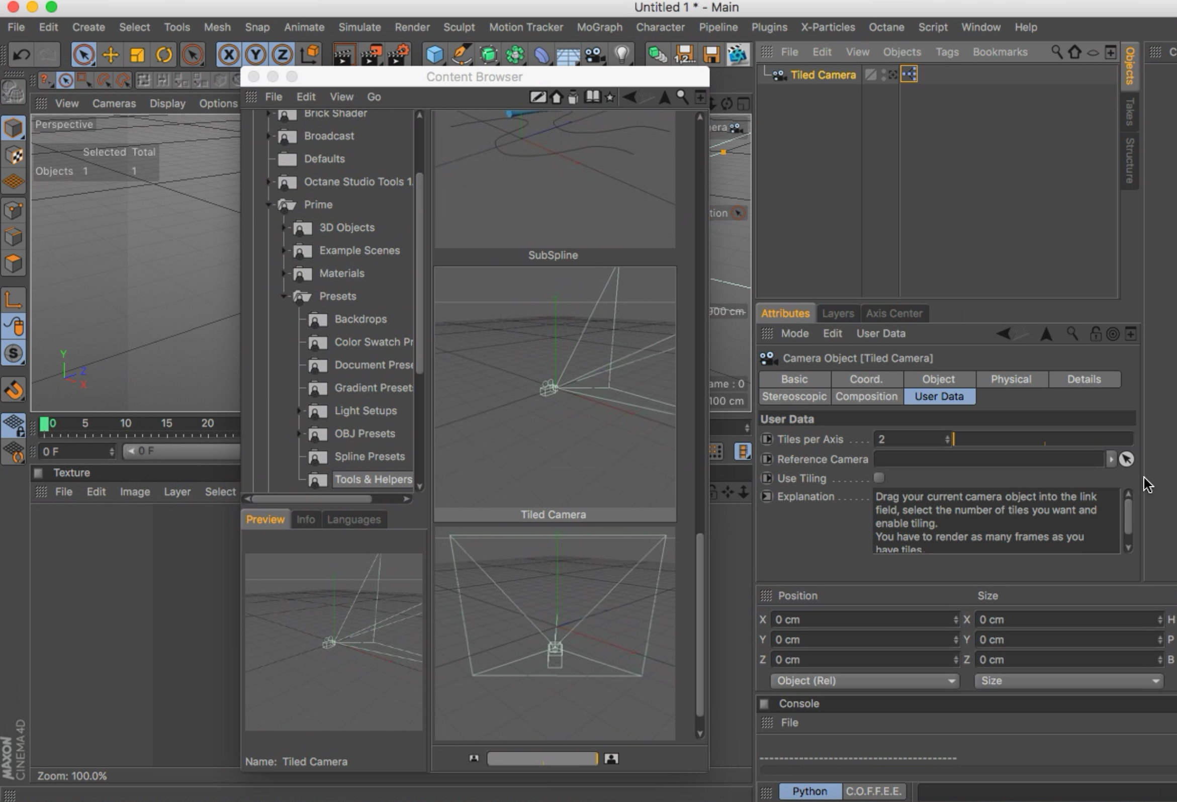

If not enough, you can use the Tiled Camera rig with lower resolution, and compose back the frame in PS, but you need to remove vighetting and post effect.

what's the tiled camera rig? never heard of it, sounds interesting

About the Tiled camera, open c4d Content Browser, and navigate to Presets/Prime/Presets/Tools & Helpers:
viewtopic.php?f=85&t=68503

with the tiled camera rig seem to work on a simple project, i'm going to try on a heavier file
