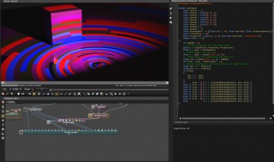

roeland wrote:A basic shader for a laminate floor looks like this:
Code: Select all
#include <octane-oslintrin.h>
shader Laminate(
    color plank1 = .3,
    color plank2 = color(0, 0, 1),
    color plank3 = color(0, 1, 0),
    color plank4 = color(0, 1, 1),
    color plank5 = color(1, 0, 0),
    color plank6 = color(1, 0, 1),
    color plank7 = color(1, 1, 0),
    color plank8 = 1,
    color plank9 = .1,
    float plankAspect = 5 [[float min = .01, float max=100, float sliderexponent=3]],
    matrix Transform = .25,
    point Projection = point(u, v, 0) [[string inputType = "projection"]],
    output color c = 0)
    int AMOUNT = 9;
    // use the projection and transform inputs
    point p = transform(1/Transform, Projection);
    float y = p[1] * plankAspect;
    // random offset for each row
    float x = p[0] + noise("cell", y, 0);
    // random plank and orientation for each cell
    float rnd = noise("cell", x, y) * AMOUNT;
    int flip = (rnd - floor(rnd)) < .5;
    // make UV mapping per cell and evaluate the right texture
    float plU = x - floor(x);
    float plV = y - floor(y);
    if (flip)
        plU = 1 - plU;
        plV = 1 - plV;
    if      (rnd < 1) { c = _evaluateDelayed(plank1, plU, plV); }
    else if (rnd < 2) { c = _evaluateDelayed(plank2, plU, plV); }
    else if (rnd < 3) { c = _evaluateDelayed(plank3, plU, plV); }
    else if (rnd < 4) { c = _evaluateDelayed(plank4, plU, plV); }
    else if (rnd < 5) { c = _evaluateDelayed(plank5, plU, plV); }
    else if (rnd < 6) { c = _evaluateDelayed(plank6, plU, plV); }
    else if (rnd < 7) { c = _evaluateDelayed(plank7, plU, plV); }
    else if (rnd < 8) { c = _evaluateDelayed(plank8, plU, plV); }
    else              { c = _evaluateDelayed(plank9, plU, plV); }
How to use: the OSL texture node node will have 9 texture inputs named plank1 to plank9. Connect each to an image texture, and for the image textures set the projection to “OSL UV”.
-Roeland
Would love to get this working, but I get the following output:
Code: Select all
Script: [string "Script"]:1: unexpected symbol near '#'
Octane 2022.1.1 nv535.98
x201t - gtx580 - egpu ec
Notiusweb
Posts: 1285
I am able to get it to work in V4_R3 (in this case I am projecting it as an emitter onto the floor. )
But Roeland's code seems good, the OSL-language compiler accepts it.
