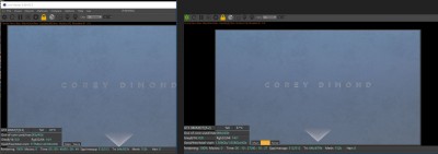

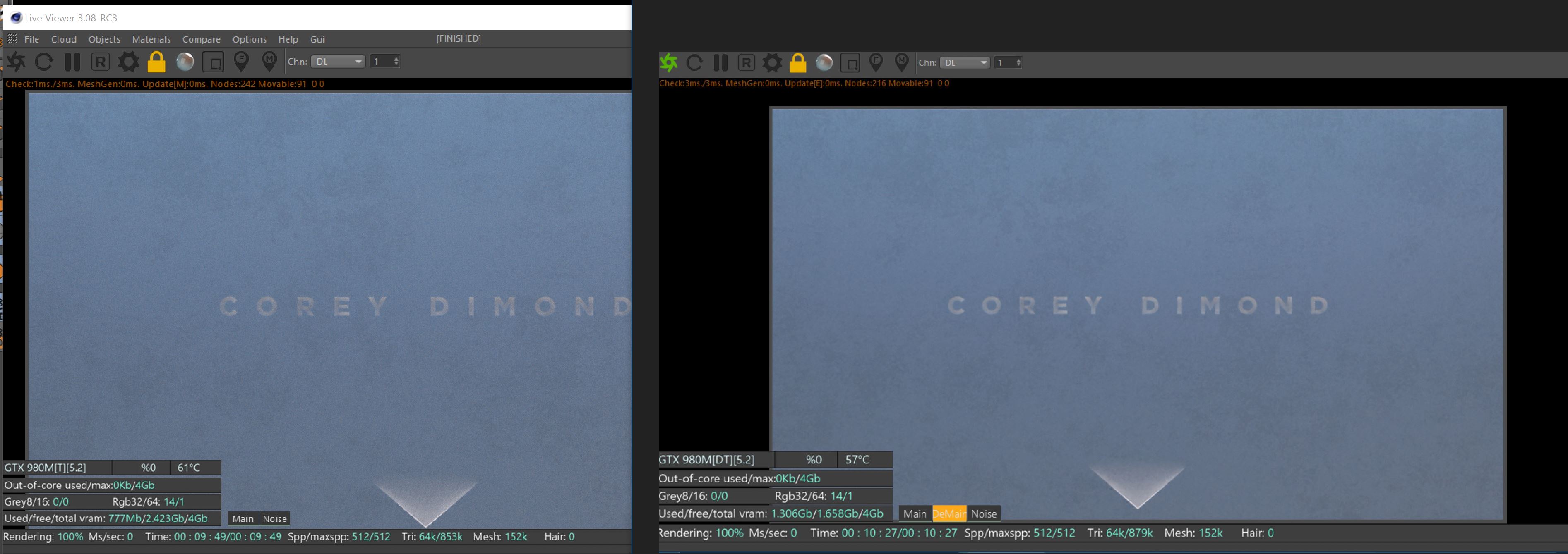

I'm testing this version and it's very stable. Good work Aoktar. How can I use the Beauty denoiser in After Effects pass? the resulting image, like the beauty pass is very dark.
Render in C4D:
Extractor in AE:

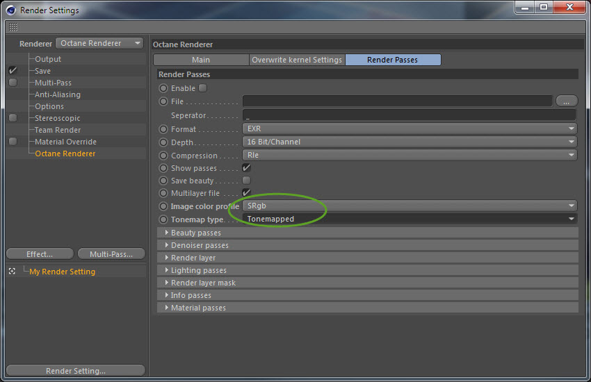

Thanks for icon!Nando_The_Fly_Design wrote:I'm testing this version and it's very stable. Good work Aoktar. How can I use the Beauty denoiser in After Effects pass? the resulting image, like the beauty pass is very dark.
I take advantage to share an icon for the material unviersal, if it serves you. Greetings!

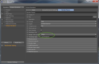

You can apply gamma correction for linear results or just change tonemap type, etc.. as in picture.

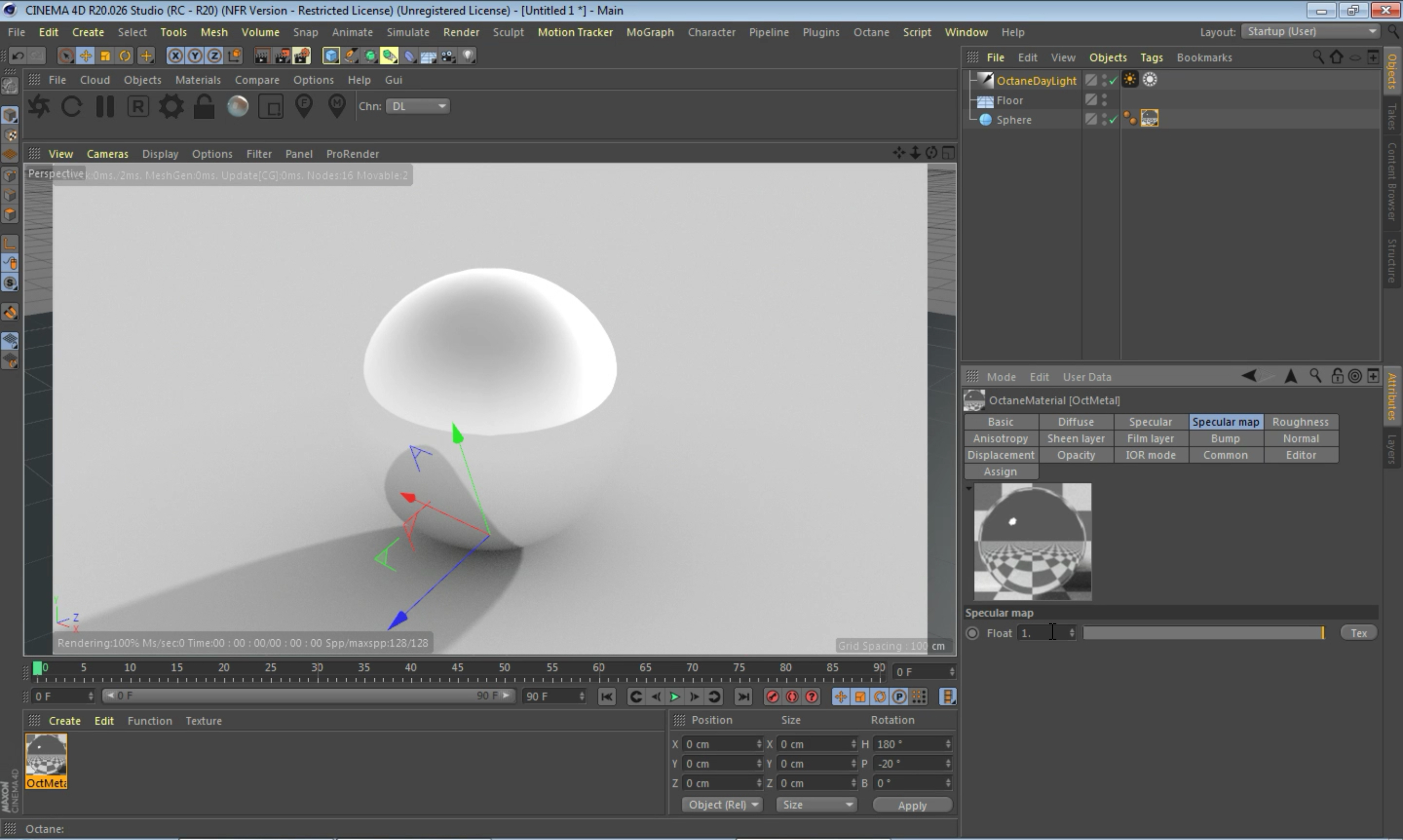

In this version creating Metal textures does not work at all for me. Cycled through Octane, Beckman, and GGX, played with the IORs on each, changed IOR modes and I only get white diffuse material in the texture preview as well as the live viewer. Changing the diffuse changes the color, but still not metal. Changing the roughness and the spec have no effect on the material. Restarted and still no luck, noticed this the other day but thought I was just messing something up. If I open an old project with metal textures those still work, it is only when creating new ones. Even if I try to create new metal textures next to working metal textures it does not work.

@tobydalsgaard;
please, set the Specular Map value to 1 for the Metallic material: @cobradimond:
the issue has been already solved in v4RC3 SDK, and the fix will be present in the next release.
