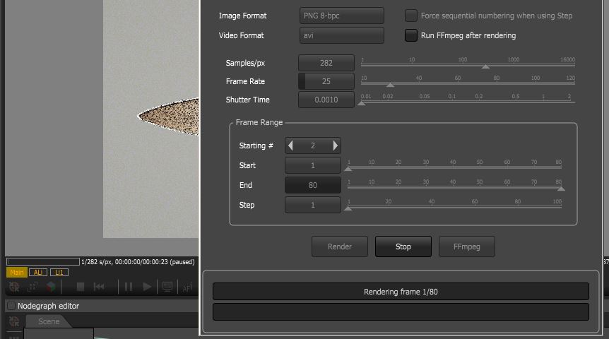

Well...actually it seems that if I increase the samples/px to about 500 it pauzes again after the first frame.. :o
If I increase the samples/px from 1 to 10, it renders perfectly every frame.
Here I increased the samples/px to 282 and it shows paused
