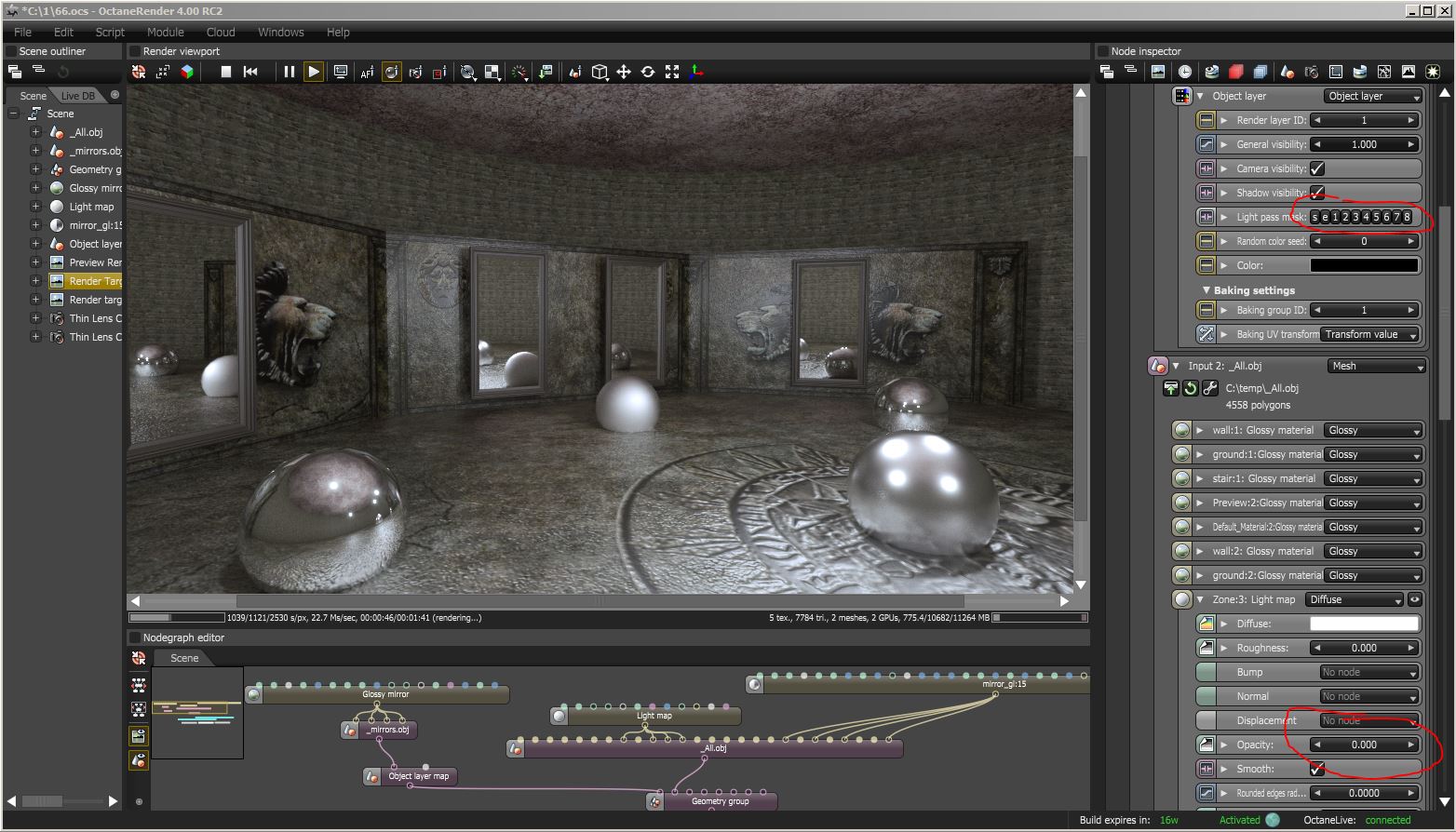

I use OC4 RC2 and there you can isolate the mirrors and put them in a Object Layer Map. Then mask the light in the Object Layer and hide the lights from the scene. Then the mirrors will not see or reflect the lights but everything in the scene will.
Maybe you can do something similar with layers in the current plugin version - I don't know.
But in OC4 it looks like this:
Win 11 Pro | i5 12600K | 32GB ram | 2x GTX 1080Ti + 3080Ti - studio driver 581.57| Modo/Blender/ZBrush/Daz/Poser

Zay wrote:I use OC4 RC2 and there you can isolate the mirrors and put them in a Object Layer Map. Then mask the light in the Object Layer and hide the lights from the scene. Then the mirrors will not see or reflect the lights but everything in the scene will.
Ohh, Yay!
That would be a dream come true, hehe.
How long I've been waiting for this.
Hopefully this will somehow find it's way into the Poser plugin as well.
