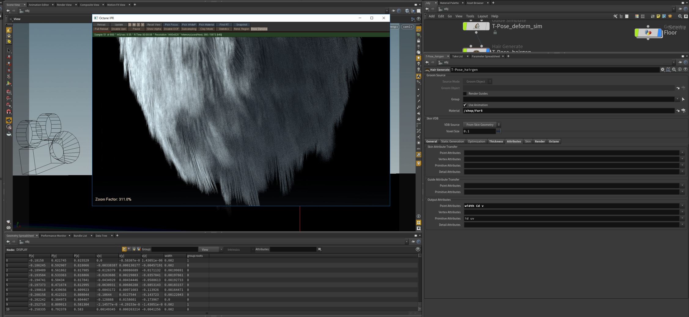

Like I had supposed, the problem was the lack of the velocity vectors (the "v" point attribute) in the final curves OBJ node. As you can see in the attached image, you must add the "v" point attribute to the output attributes in the hair generate OBJ node.
Hope it helps,
-Juanjo
