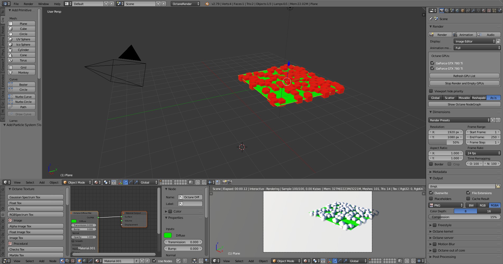

this is an example:
particlesystem-problem.blend
(523.56 KiB) Downloaded 291 times
create a simple plane and a simple cube (in different layer)
if use particlesystem (layer of dupli object off) the material of the cubes is lost…
lost material
lost material
thanks for your help!!! ;)

I just tried your scene, although on 16.2. It looks to me that your scene is having issues, when I load the scene I can't see the red cube but it does show up in the outliner. I recreated the scene and I was able to get it to work with shift-d to duplicate the object with the particle system and materials.
particlesystem-ok.blend
(674.46 KiB) Downloaded 276 times
* Ah, I see that it's on another layer. I just tested it with my scene and if I move the cube to another layer, the plugin can no longer see the texture. Looks like a bug to me. If you move the cube back to the same layer it will work again. Checked rendering with F12 too, doesn't work either.

Looks like both objects (emmiter and particle) need to be on the same layer. There was a change in plugin that it does not compile objects that are not visible (outliner eye) and that are not on active layers.

in the previous version I used it was different.
it was very neat to keep groups of objects on a disabled layer and to use them in particle systems on objects in the scene.
I do not like it now that works like this... Patience, I will change the projects and templates on what I'm working on.
