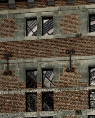

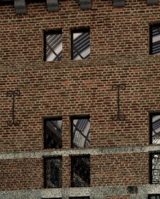

Hi and thanks for this release,
Great to be able to compress textures, though I met a very strange issue, see the sample below, the first image is rendered with the original texture, the second one with the compressed texture.
Images are in jpg format, any idea why I got this result, and where do it finds those bricks that replace the stone ?
Edit : Well after examining the image texture, it seems that the image is shift up, the bricks come from the bottom of the image.

Confirmed here too. Enabling compression seems to be changing the way a texture is UVed. I have an image of some text UVed, and it flips upside downenricocerica wrote:Hi and thanks for this release,

Yes, I broke that on Monday shortly before we released. Sorry about that. It will be fixed in the next build.enricocerica wrote:Hi and thanks for this release,
