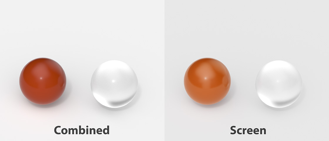

Hey.
Can anybody give me an advice about how to combine beauty passes in Photoshop correctly? When using "Linear Dodge (Add)" the result comes out way too bright. When using "Screen" as some suggested, the result still looks different from the Combined pass. I used both Diffuse passes, both Refelction passes and the Refraction pass on top of each other.
Here'a are the two tests.
Any help is appreciated.
Cheers,
Andreas

Hello, JC.
Thanks for the feedback. I tried the extension but it requires a format called OCPRJ that I don't have and don't want to use either. I'm fine with any file format that Blender can export.
As for the tutorials. I've watched them before but it doesn't work like that with Blender. As you can see above, the "Linear Dodge (Add)" belnding mode results in a much too bright image. The tutorials use PSD as export image format which is not an option in Blender, although I don't think that should make a difference. Maybe it's about the way images are exported in Ciname4D compared to Blender.

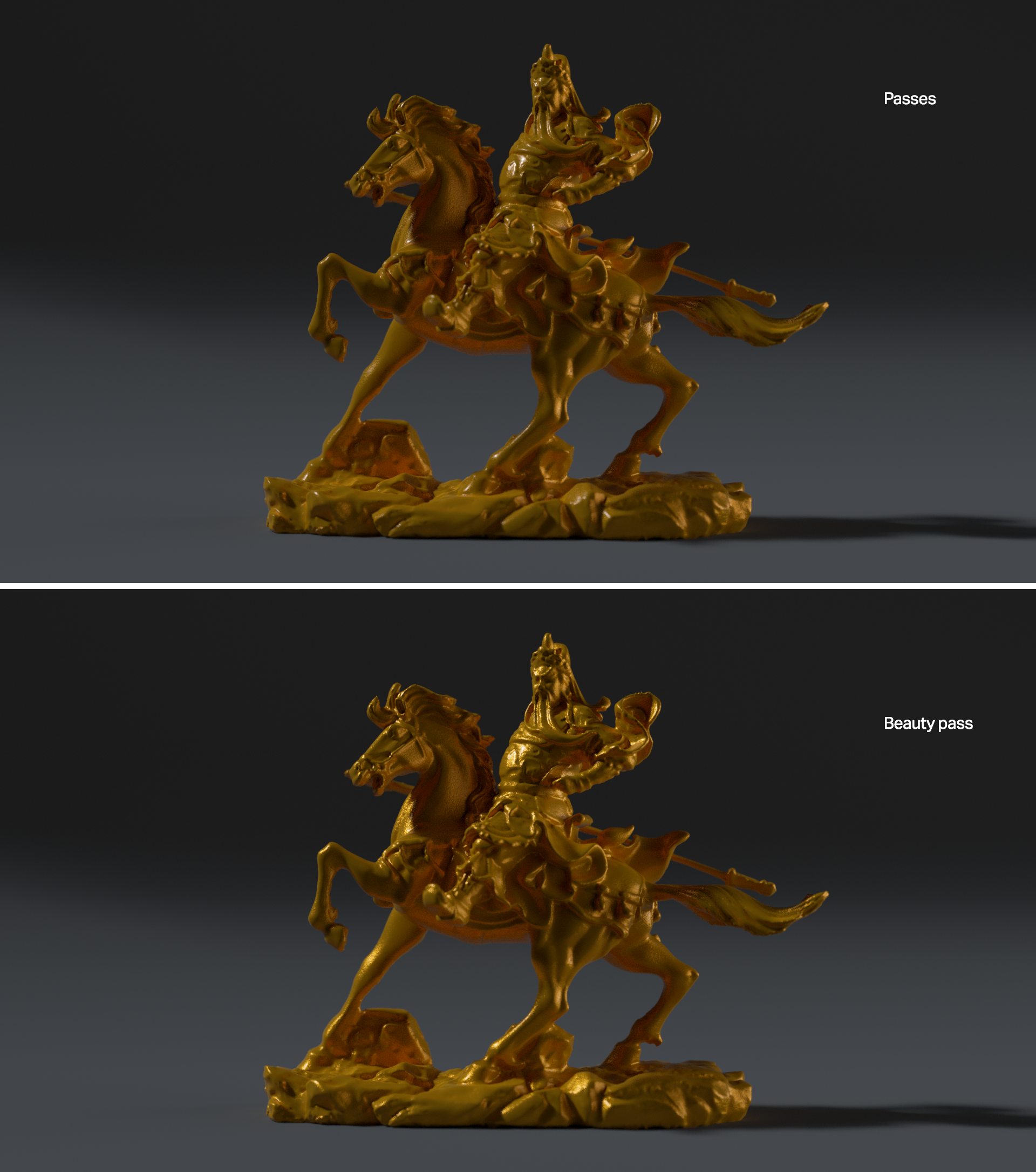

I've experimented for a while now and there are 3 ways to get the compositing done in Photoshop. They all use Linear Dodge (Add) as blending mode.
1) Export straight OpenEXR and correct gamma in Photoshop (32 bit)
If you export the passes as OpenEXR directly from Blender, you need to adjust each layer/pass by a gamma of 0,4545 (1/2.2). This looks something like this ...
2) Export gamma corrected OpenEXR from Blender (32 bit)
If you place a Gamma node set to 2.2 between each of the passes and the Output node, you don't need to compensate for it in Photoshop. That looks something like this ...
3) Export TIFF and work in a linearized color space within Photoshop (16 bit)
If you prefer to wotk in 16 bit you need to convert your imported passes to a linearized color space with a gamma of 1. Of course you have to save it in this color space as well if you want to preserve the layers. I've uploaded the ICC file in case you should need it.
http://www.andreasresch.at/upload/Linear%20sRGB.icc
I will see which one of this methods I will use - probably 2 or 3.

Hi Andreas,
Can you provide your .blend file and photoshop to compare? I can't get the same results when doing passes too.

Hi Andreas,
I prefer any workflow that works :)
The closest results I get is method 2 but the indirect reflection pass quite subtle in this mode.
What is your camera imager settings?
