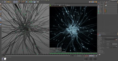

Hello all,
Was wondering if anyone knew how these materials were created.
I can't figure out how the glass tube material was made. I tried a specular material but cannot recreate the one in the link and image. it also takes a really long time to render when I lower the Rey epsilon, and I thought I needed that to recreate the glass tube material.
Any ideas?
Thanks in advance!
https://www.instagram.com/p/Bjz75fWgCKy ... _copy_link

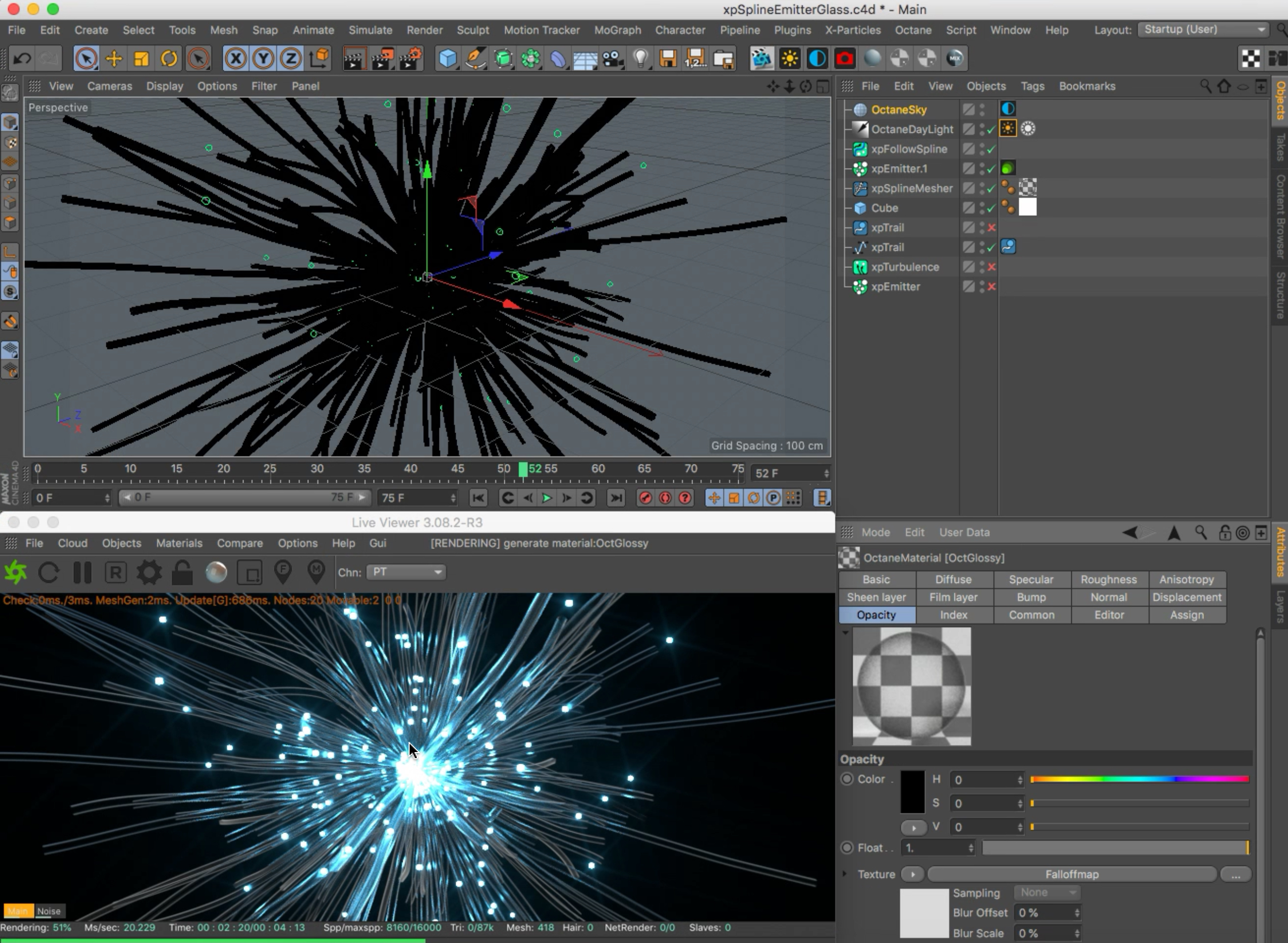

Posts: 10597
here is a possible solution with X-Particles:
I have used a Glossy with Falloff in Opacity, instead of a Specular material for the transparent tubes.
ciao Beppe

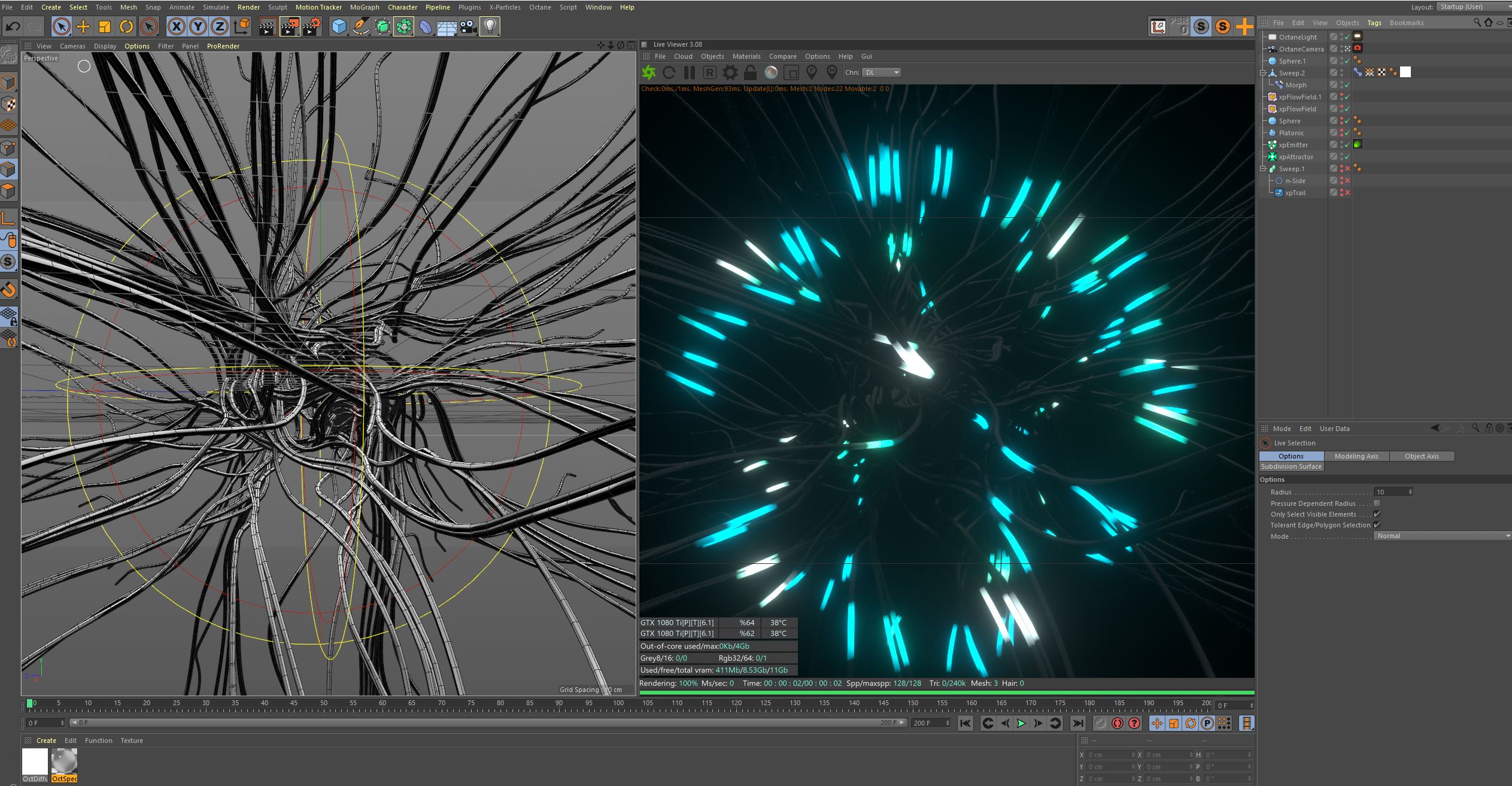

rooster
Posts: 19
Joined: Sun Feb 05, 2017 10:01 pm
Thanks bepeg4d!
What I'm trying to achieve is the blurred glow light source effect in the first attachment.
I can kinda achieve it when I increase the roughness of the secular/glass material, but then the reflection in the glass goes away. You can see this in the second attachment.
Octane forum, any ideas on how to obtain this effect?
C4D file here:
https://www.dropbox.com/s/aofrwknujsygp ... 9.c4d?dl=0
Many thanks in advance!
rooster
Win 10 64| 2*Geforce GTX1080ti | i9-9900K 3.60GHz |64GB

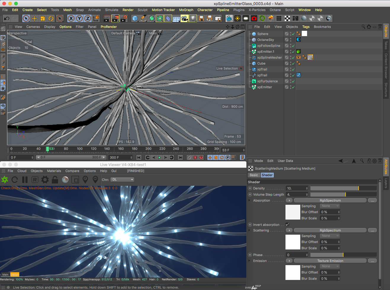

Posts: 10597
here is my attempt with Specular material with Scattering Medium node, I hope it could be useful:
xpSplineEmitterGlass_0003.c4d.zip
(368.25 KiB) Downloaded 299 times
ciao Beppe
