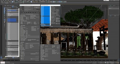

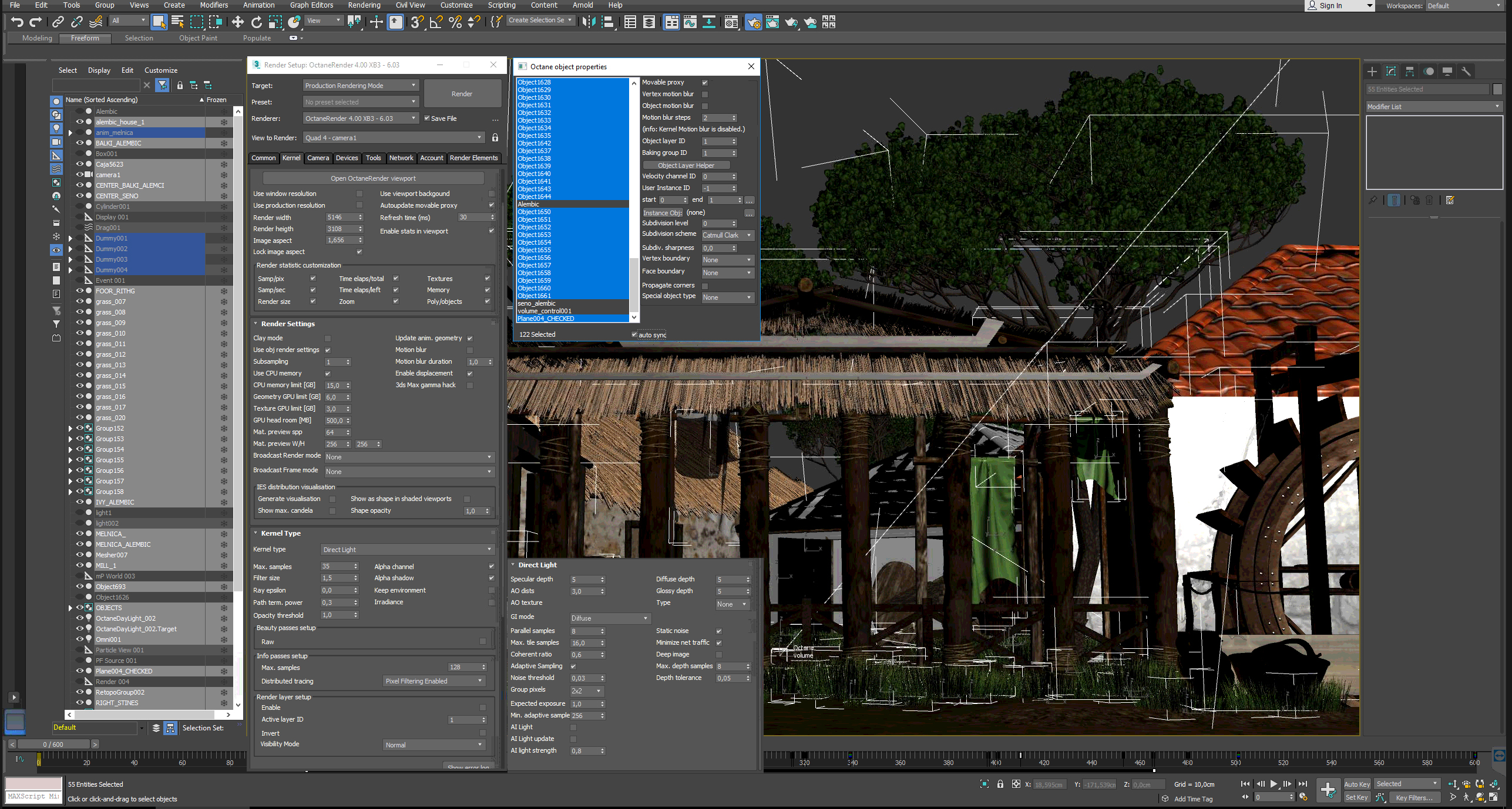

There is a very complicated scene. built entirely on heavy alembic files. (all animations baked)
The preview in half resolution rendered, the first frame was considered to be long, 15 minutes, but the second-third and all the subsequent ones were rendered quickly (2 min per frame).
Increased the resolution, everything stopped working, 30 minutes per frame. In live preview 4 min per frame.
The drivers are new. 2 cards. Gtx 1080 and Gtx 1080
settings
settings
