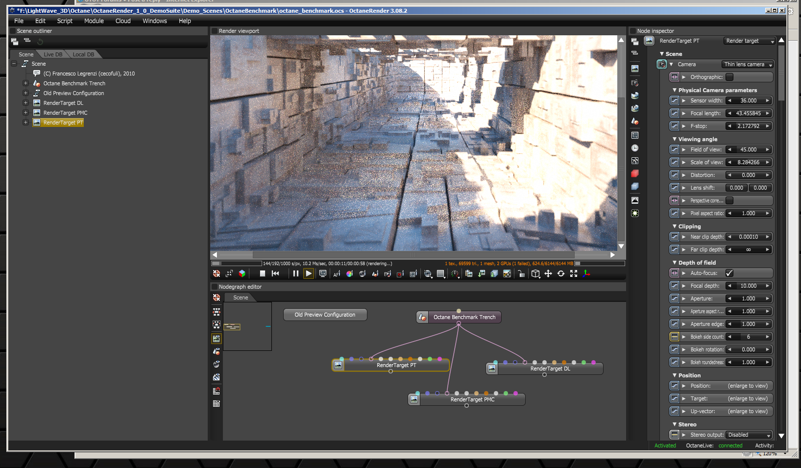

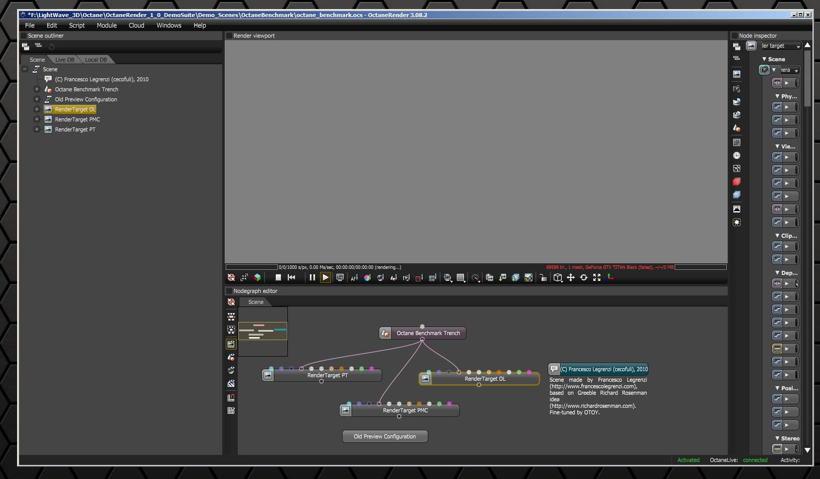

Ok I have not run Octane Standalone yet I will do that..
Ok the GTX 1080 works in standalone fine by itself
Ok the Titan Black has problems when both cards are active
The Titan Black wont run by itself?

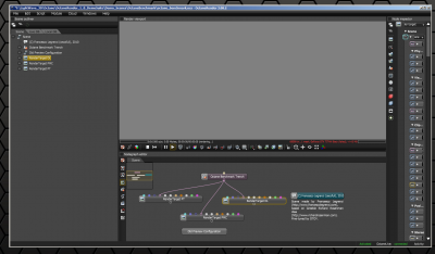

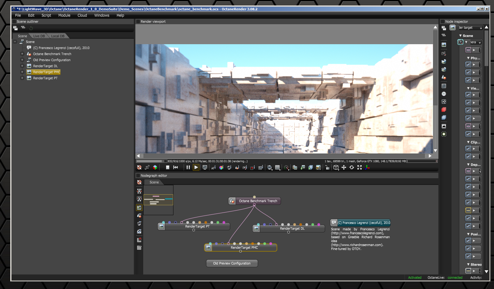

It is the opposite when I am in lightwave? the Titan runs fine the 1080 wont???
Standalone Log file
CUDA error 2 on device 1: out of memory
-> failed to bind device to current thread
device 1: failed to initialize context
CUDA error 201 on device 1: invalid device context
-> failed to create link
device 1: failed to create OSL compile context:
device 1: failed to compile module 0

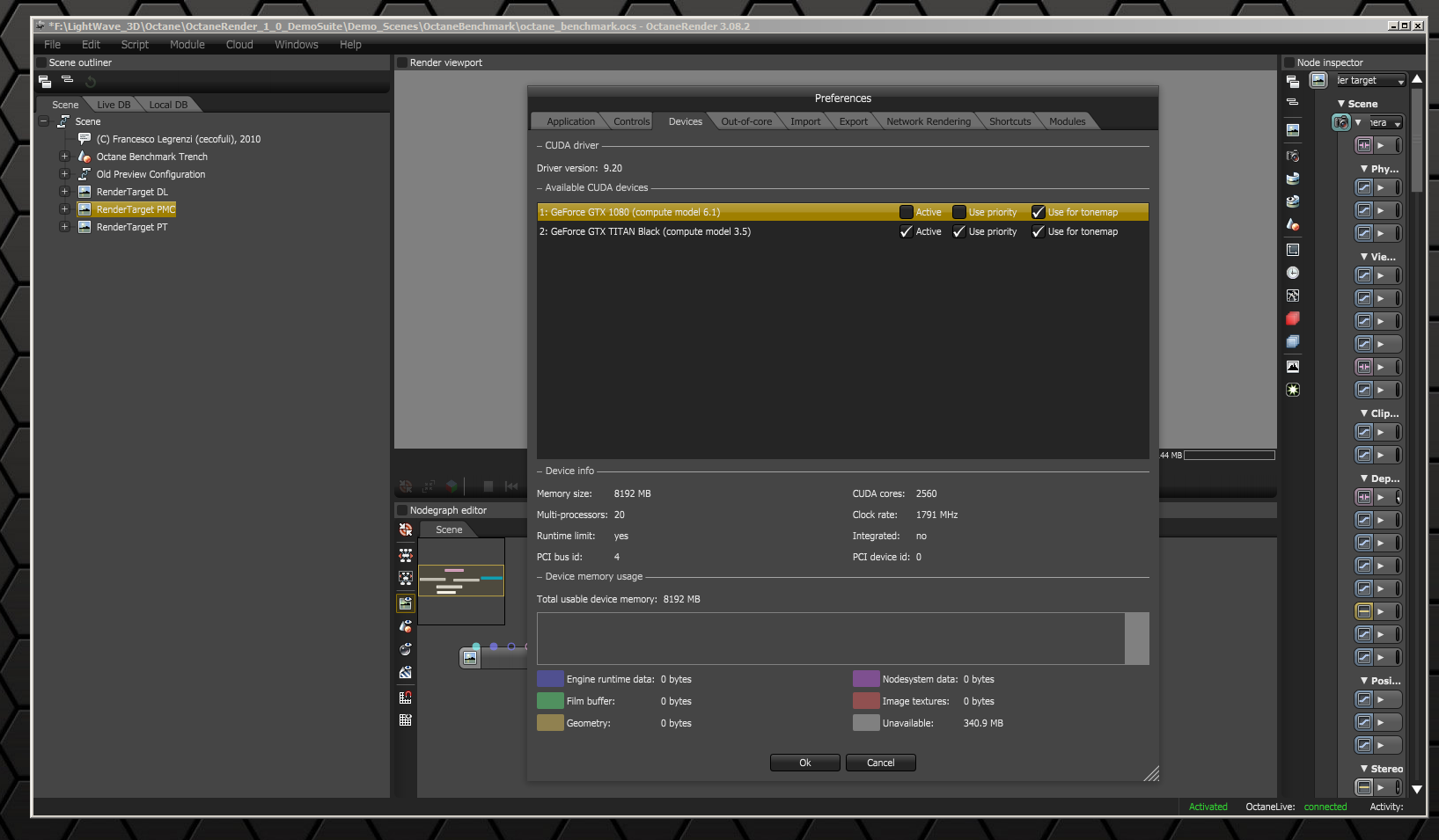

Both cards active
Both cards active
GTX 1080 only
GTX 1080 only
both cards in preference Devices
Titan Black only active

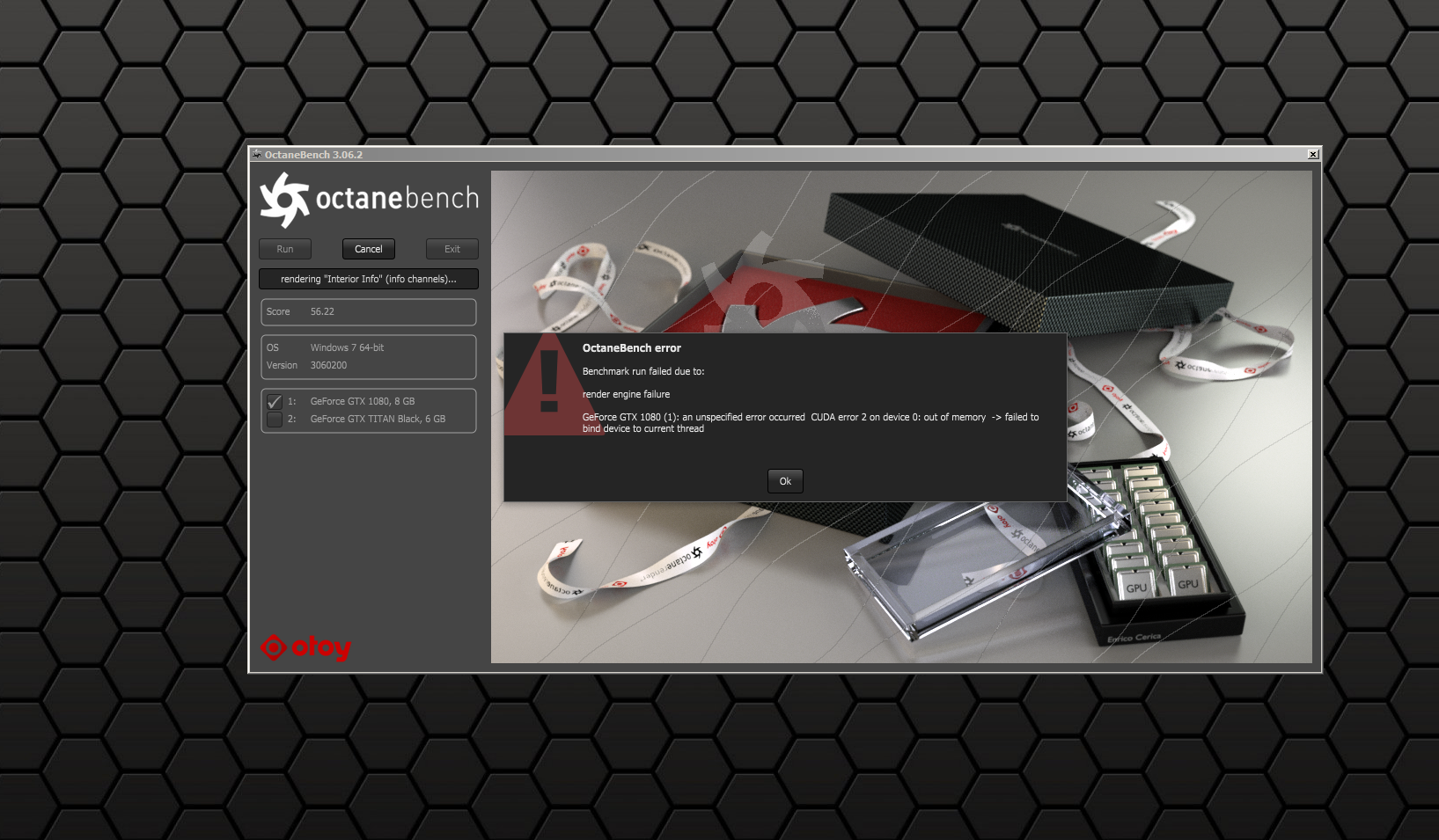

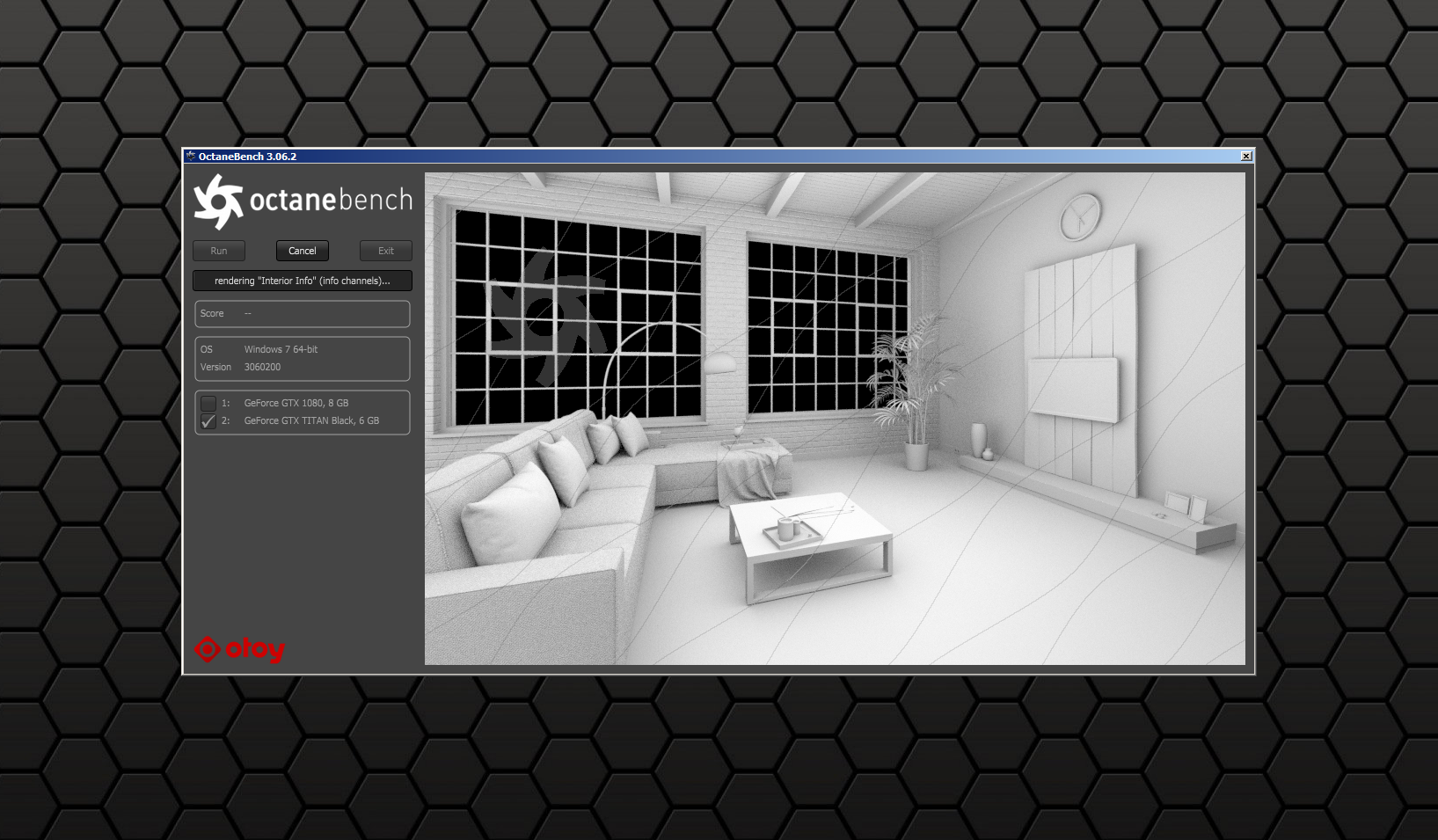

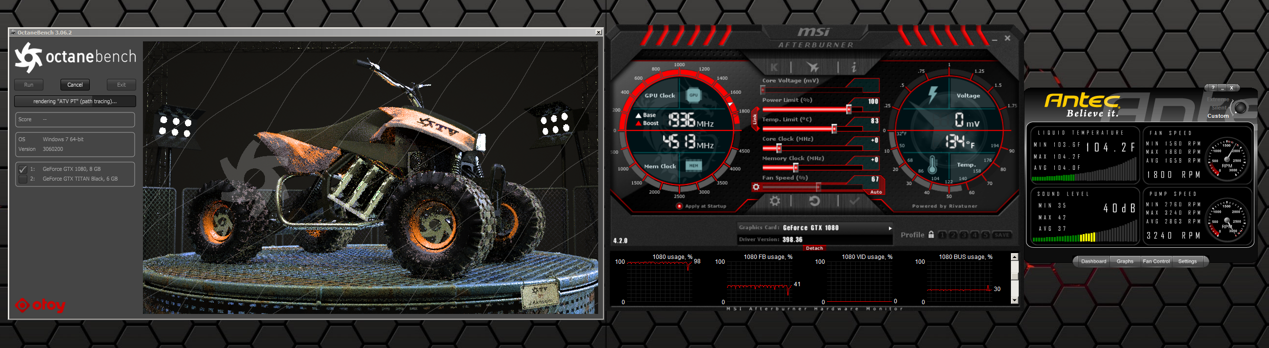

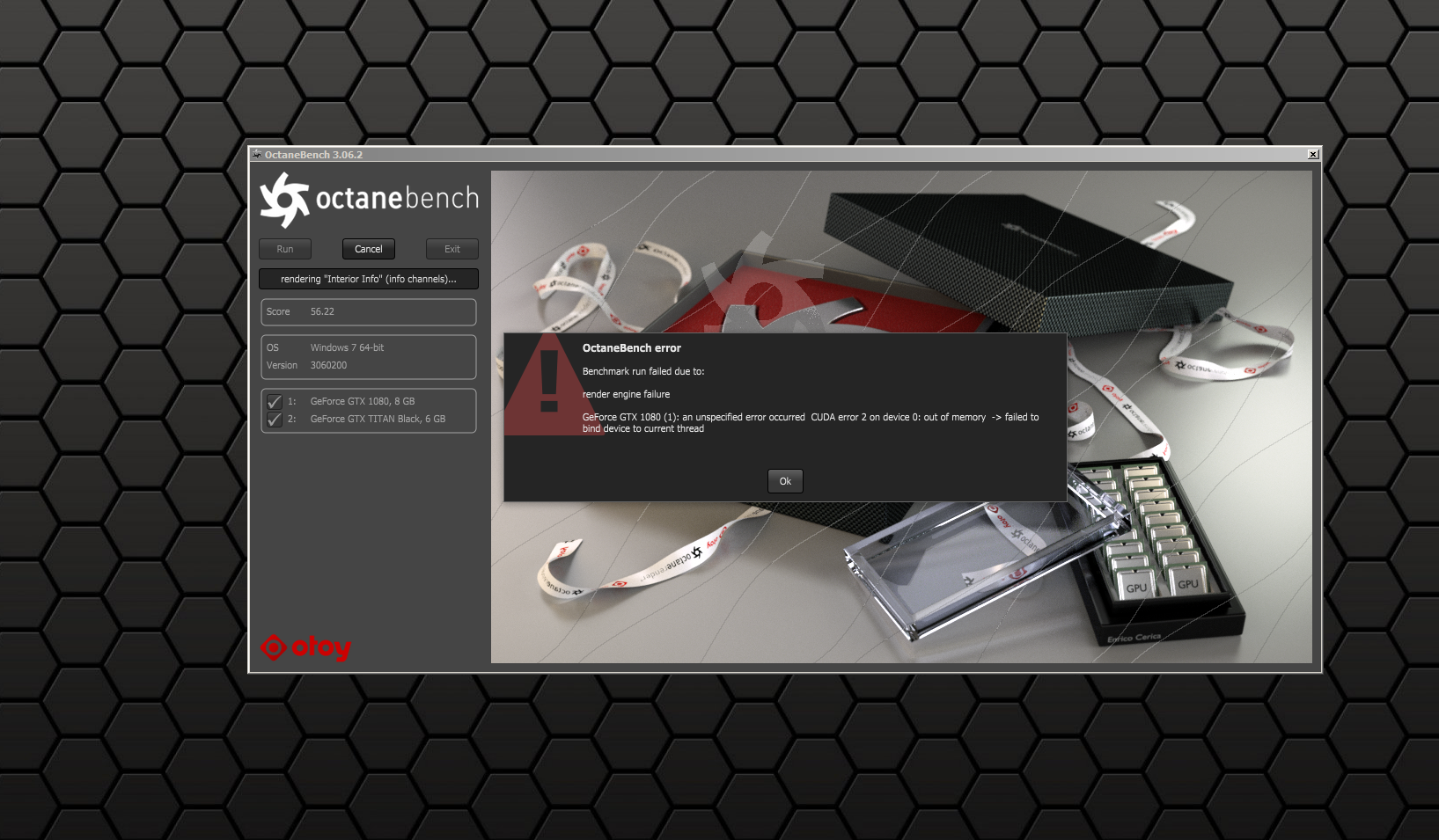

So I thought I would download the OctaneBench® 3.06.2 and run it..
Had both cards enabled, thru an error that 1 failed?? hmmmmm
Single Card Titan Black
Score - 56.22
OS - Win 7 64 bit
Version - 3060200
The GTX1080 failed..??
hmmmm
Interesting, Standalone likes the GTX1080 ... hates the Titan hehe
The Bench Mark likes the Titan Black ... hates the GTX1080 hehe
Lightwave likes the Titan and hates the GTX1080 hehe

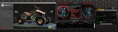

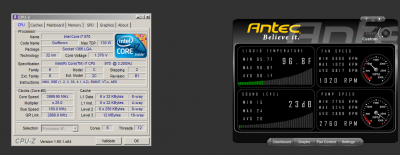

Do you have a GPU/CPU monitor running at all? What are the temps for these pups, when running full blast? Seems to me that when folks have crap overheating, or if a PSU is not fully up to the task, things can get pretty dodgy.. unpredictable...
I use Open Hardware Monitor, and love it. Very light weight and compact. I've got my GPUs and CPU temps sitting right in the system tray, and I have a different color applied to each, so I know which is which. Always on top of my temps. Not that I need to keep an eye on my hybrids and watercooled cpu, but if the "fit hits the shan", I would know quick.

I use MSIAfterBurner to monitor GPU's and water cooled CPU
Temps have never been the issue...
But I will double check them.
Things seem to be fine, just cant seem to figure out why I can't use both GPU's, interesting...

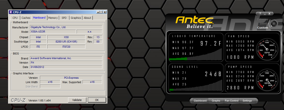

No PLX chipset
Intel Chipset - X58
Mike
LIGHTWAVE64_short.txt
Motherboard info
(117.06 KiB) Downloaded 286 times

Downloaded the GURU DDO and removed the 398.36 NVidia drivers and installed the 387.92 drivers and all is working now
Both GPU's are running again...
